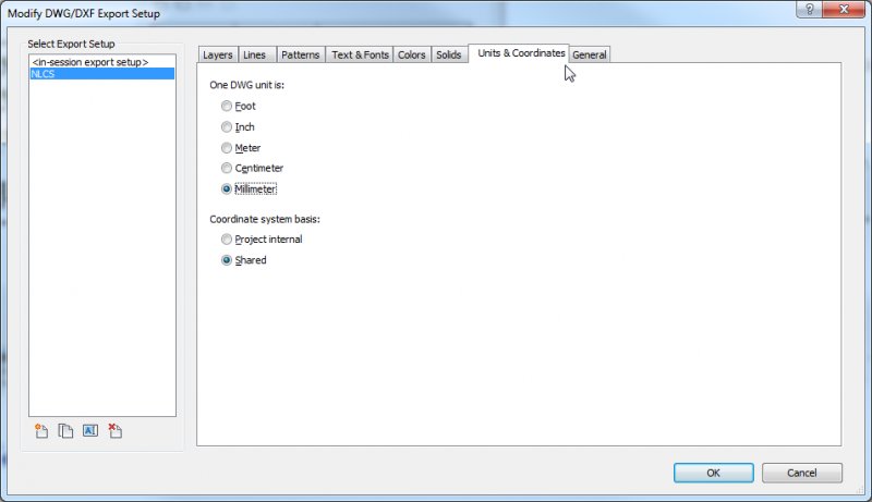

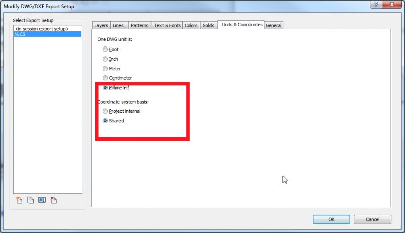

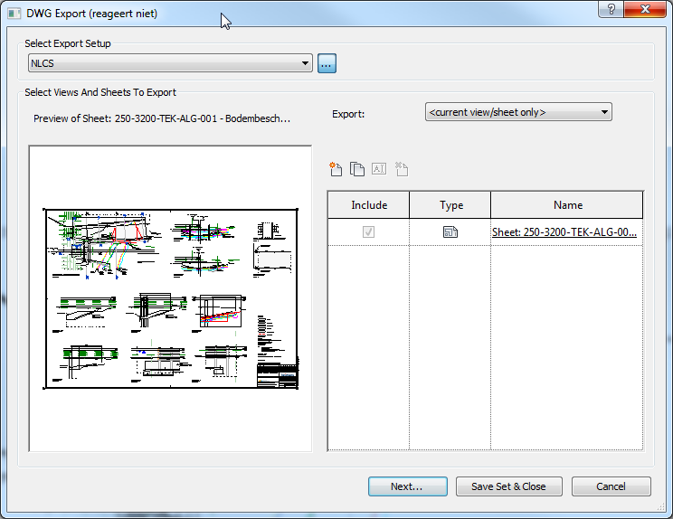

Most Civil engineer know that is very important to have a design made according to your local coordinate system. Typically in AutoCAD you draw your top view in coordinates. What I did not accomplish yet with Revit is to export my sheets in a right way. And I do not mean a view but complete (/set of) sheets. Is this possible ? How?

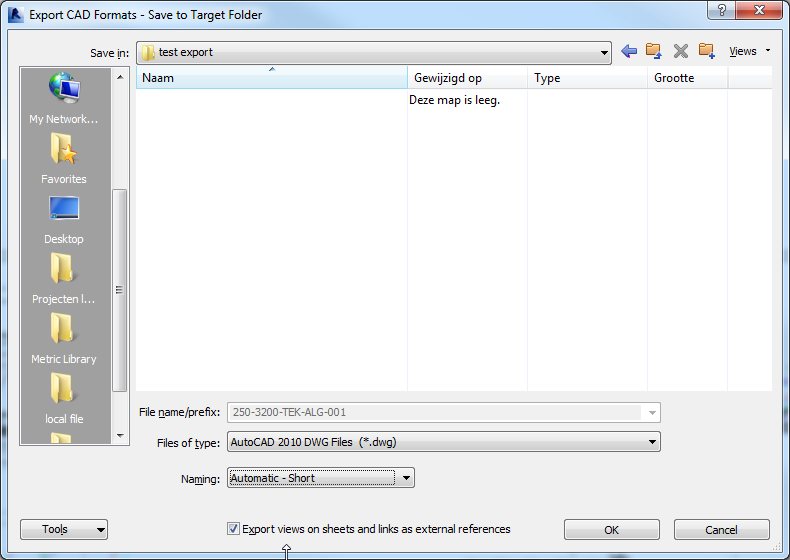

Revit has an option for exporting using project coordinates. Views on sheets and links can be exported as XREFs. I ran a quick test and it looks like Revit makes a unique XREF for each view and maybe a central one for links. Depending on what you are starting with and your desired result you may have to create special views for exporting for use as an XREF for your sheets. It looks very doable, but may take some work on your part.
BTW, don't do the automatic naming when you export. In my test the file names were outlandishly long.

Indeed, We use shared coordinats methology settting survey point and project base point. But the problem is that sheets do not get oud the same way as views. It does not really matter if you set this up for somewhere in the usa or in europa. Can you make dwg sheets come out the same way as a single view?

Have you tried the XREF method when you Export? The last step of the DWG Export box, there's a checkbox enabling or disabling XREF exports for the "drawing" portion. I haven't personally ever checked to see if the origin is in place, but I guess I could try to confirm. Just thinking out loud at the moment to see if this has been tried or not.

halam
must lost my password along the way I now remember.
Using differentt machines. I don't mind if you just delete one of me ..;-)
I would like to get get back to the topic if this is still possible.
Drawings as revit output is still impotent stuff after all!
Export to separate Xrefs I tried but did not make much difference.
To me it just seems that the checkboxes just do not work as they are intended (that is, views together in a sheets, options?)
Would like confirmation about this defect or sincerely would like the right workaround..
Any other suggestions what I should try?
