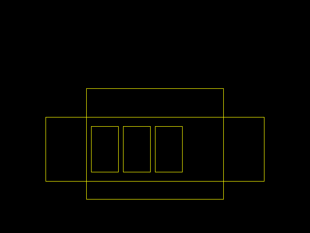

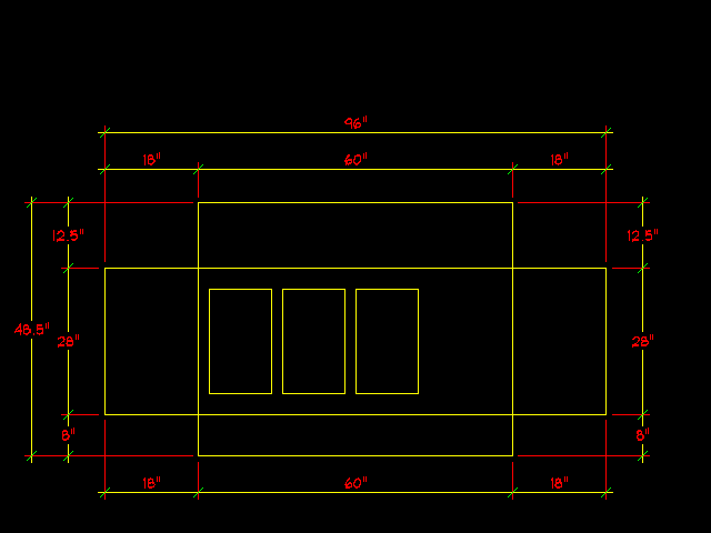

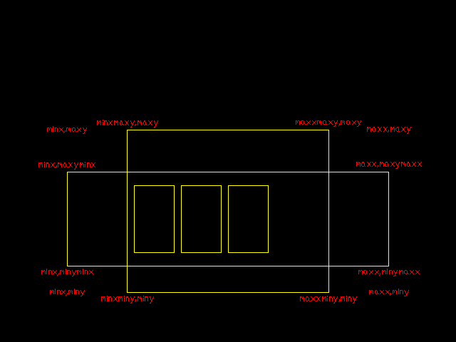

I use something like this a lot for automated dimensions for line drawings. It maybe of some use :

This is a stand alone auto_dimension of a sort.
These ARE NOT associative DIMENSION entities.
There are several personal settings that can be manipulated to your tastes

 (setq minx (apply 'min (mapcar 'car pl))
       maxx (apply 'max (mapcar 'car pl))
       miny (apply 'min (mapcar 'car rl))
       maxy (apply 'max (mapcar 'car rl))
   minyminx (apply 'min (mapcar 'car (massoc minx pl)))
   maxyminx (apply 'max (mapcar 'car (massoc minx pl)))
   minymaxx (apply 'min (mapcar 'car (massoc maxx pl)))
   maxymaxx (apply 'max (mapcar 'car (massoc maxx pl)))
   minxminy (apply 'min (mapcar 'car (massoc miny rl)))
   maxxminy (apply 'max (mapcar 'car (massoc miny rl)))
   minxmaxy (apply 'min (mapcar 'car (massoc maxy rl)))
   maxxmaxy (apply 'max (mapcar 'car (massoc maxy rl)))

No error checking or trapping
4 Dims per side - Overall, Rh Min - LH Min - Center Balance
Have Fun ! -David
Edited by David Bethel
Fix Z axis problems
looks like exactly what the dragon , pardon , doctor ordered , thanx Lee , real smooth :D
Thanks rlx, you're welcome :)
