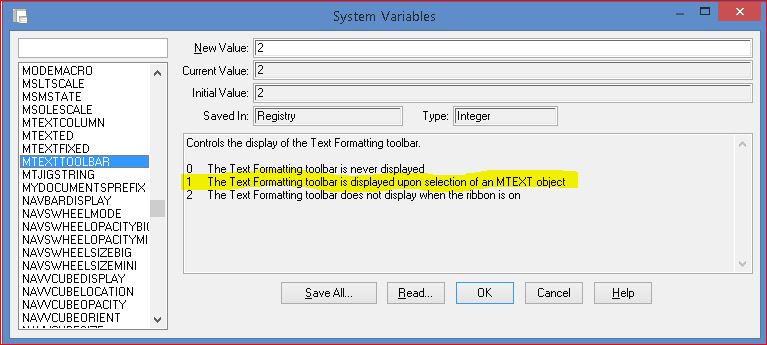

Dadgad Posted August 12, 2015 Share Posted August 12, 2015 Glad to hear that you are back on the tracks. Perhaps this would be a good time to learn about, or implememnt, the saving of an .svf (system variable file). Use the SYSVDLG command to open the system variable dialog box, and when you feel you have your settings returned to how you like them, use the SAVE ALL button at the bottom of the dialog. There will come a day, when you will be glad you did. Just make sure you save it somewhere you will remember, and be able to find it, when you DO need it. Quote Link to comment Share on other sites More sharing options...
Franklyn83 Posted August 12, 2015 Author Share Posted August 12, 2015 Hi Dadgad, that would be fantastic, thank you for the tip. I typed the command and got a system variables dialog box, in the upper right hand there is a blinking cursor, seems to be prompting me to type something in? left it blank and clicked the "save all" button and was able to save a file to a folder. I had to re-name it in order to save it but it still has the .svf designation at the end of the file name. Hope this is right so far. My follow up question is, how do you use this file I have saved to restore my settings. What are the steps/commands required to re-introduce my .svf file into autocad? Quote Link to comment Share on other sites More sharing options...
Dadgad Posted August 13, 2015 Share Posted August 13, 2015 (edited) If you look at the screenshot, I have circled SAVE ALL, which ideally would be reclicked whenever you change a system variable setting (assuming it is not just a temporary change, which might be task specific). In that way your prefered personal settings can easily be copied to another computer, shared with another user, or restored. Should you need to apply or restore these settings in the future, hit READ, then browse on your computer to the saved .svf file. For a single variable change, on the fly, you only need hit OK at the bottom of the dialog, but such a change will not be automagically updated in your SAVE ALL safety file. If you mean to save it, hit OK, then SAVE ALL to overwrite your backup copy. The dropdown list on the left is a wonderful resource, as it briefly describes the different settings available for most Autocad commands. Better to scan the list, searching, than enter a name at the top in the blinking field, because you will learn a lot more by scrolling through the list. By using your keyboard cursor arrows, you can quite easily browse through them, which can be extremely informative, time permitting. It also makes it easy to flip through a sequence of subject related variables, when you are not sure which might come into play, such as if you know you have a DIMENSION problem, you can scroll through all of those starting with DIM. Or as in the screenshot, you could easily scroll through the PICK related variables with your cursor arrow. Edited August 13, 2015 by Dadgad Quote Link to comment Share on other sites More sharing options...
