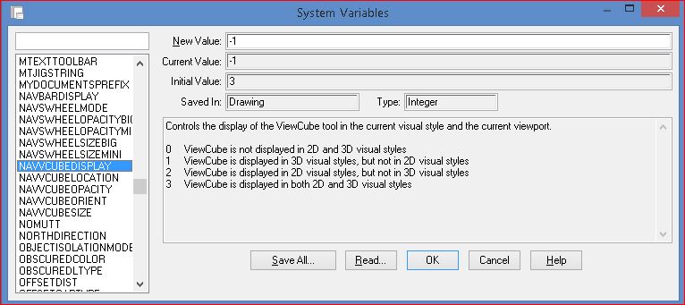

Dadgad Posted August 20, 2015 Posted August 20, 2015 (edited) Having never used such a vintage version of the software, I don't knowthe answer to this one? Did Autocad include the CLEANSCREENON concept pre 2000? If not David, hit Ctrl+0 , and you will likely be a happy camper. No doubt you have figured out how to kill the NAVCUBEDISPLAY, by setting the variable to . Edited August 20, 2015 by Dadgad Quote

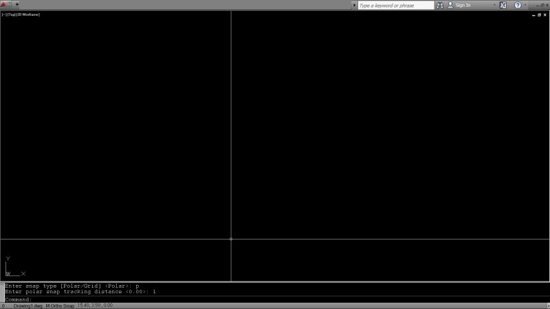

David Bethel Posted August 20, 2015 Author Posted August 20, 2015 No doubt you have figured out how to kill the NAVCUBEDISPLAY, by setting the variable to . Nope, didn't know about them Command: NAVVCUBEDISPLAY Enter new value for NAVVCUBEDISPLAY <3>: 0 Command: Enter new value for NAVBARDISPLAY <1>: 0 Thanks! How I like my ACAD workspace : ( and as close as I've gotten to in 2012 ) Quote
SLW210 Posted August 20, 2015 Posted August 20, 2015 You may want to kill off Info Center as well. http://otb.manusoft.com/2010/11/disable-autocad-infocenter.htm Quote
BlackBox Posted August 20, 2015 Posted August 20, 2015 After killing InfoCenter, looks like you need only set MENUBAR == 1 to mimic your preferred workspace. [Edit] - Don't forget that the Command Line also has improved transparency, etc. when undocked, should you want to improve on your preferred workspace, by freeing up even more screen real estate. Quote
David Bethel Posted August 20, 2015 Author Posted August 20, 2015 You may want to kill off Info Center as well. http://otb.manusoft.com/2010/11/disable-autocad-infocenter.htm Very Nice !!! Thank You Owen ! After killing InfoCenter, looks like you need only set MENUBAR == 1 to mimic your preferred workspace. Yes again ! [Edit] - Don't forget that the Command Line also has improved transparency, etc. when undocked, should you want to improve on your preferred workspace, by freeing up even more screen real estate. I do like a docked command line. Searching all over the screen for the thing can drive me even more nutty than I already am. It is looking good ! Thanks! -David Quote
