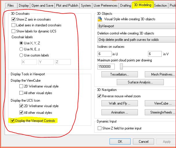

Dadgad Posted August 20, 2015 Posted August 20, 2015 (edited) You can also disable the VIEWPORT CONTROLS in the lower left corner, on your 3D Modeling Tab in Options. You may want to play around with your Crosshairs too. Edited August 20, 2015 by Dadgad Quote
David Bethel Posted August 20, 2015 Author Posted August 20, 2015 You can also disable the VIEWPORT CONTROLS in the lower left corner, on your 3D Modeling Tab in Options. I don't see a setting for that 1. It would nice to get rid of it also. -David Quote
David Bethel Posted August 20, 2015 Author Posted August 20, 2015 No doubt you have figured out how to kill the NAVCUBEDISPLAY, by setting the variable to . I can't get this setting to stick to 0. Any ideas ? -David Quote
Dadgad Posted August 20, 2015 Posted August 20, 2015 Go back and look at post #15 again, as I added a screenshot from the SYSVDLG which may help you . Quote
Dadgad Posted August 20, 2015 Posted August 20, 2015 I don't see a setting for that 1. It would nice to get rid of it also. -David Are you looking on the 3D Modeling tab? Lower left, as shown in the earlier screenshot (post #21). When I first posted, I misstated, as I thought it was on the Display Tab, but was wrong. Quote

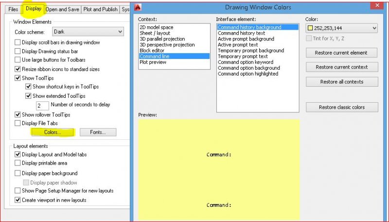

Dadgad Posted August 20, 2015 Posted August 20, 2015 If you want your commandline background to be white as shown earlier, you can set that up on your Display Tab in OPTIONS, as shown in the screenshot. You can define all of the colors for the numerous different elements. Not sure, what Restore classic colors will do, might just be what you favor. Quote

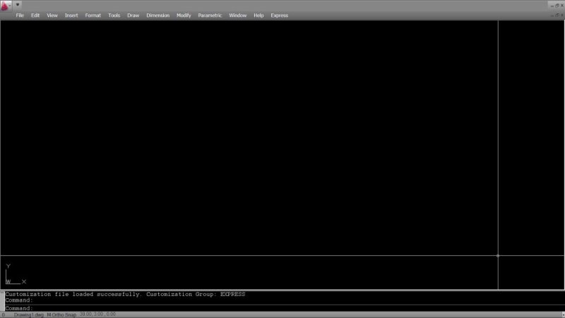

David Bethel Posted August 20, 2015 Author Posted August 20, 2015 I do use the status bar coordinates quite a lot. In the original DOS releases, the status bar was at the top of the screen and hidden by popup menus when the mouse was there. -David Quote
David Bethel Posted August 20, 2015 Author Posted August 20, 2015 There are users here who still type in DDMODIFY Guilty as charged ! For those who don't know what the interface looked like : Quote
