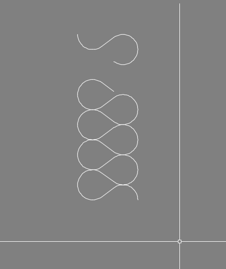

squareknees Posted September 9, 2015 Share Posted September 9, 2015 I have a dynamic block for batt insulation there is 2 thicknesses 3 1/2" and 5 1/2" I have the visibility set so each thickness had its own properties. yet I can not get the 3 1/2" insulation to work right. if you can see the image that I attached I keep getting this weird gap. all of the settings are exactly the same between the 5 1/2" and the 3 1/2" I move the last section and array the middle piece to fill the gap. for the 5 1/2" insulation is arrayed at 2 159/256" and the 3 1/2" is arrayed at 1 3/4" yet I continue to get the gap. is the distance for the 5 1/2" batt insulation effecting the distance for the 3 1/2"? thanks for all your help. Quote Link to comment Share on other sites More sharing options...

squareknees Posted September 9, 2015 Author Share Posted September 9, 2015 I didn't know if someone who has had this issue would be able to go OH this happened to me this is how you fix it without needing to see the dwg file. well here it is. Drawing2.dwg Quote Link to comment Share on other sites More sharing options...

steven-g Posted September 9, 2015 Share Posted September 9, 2015 And as ReMark Says pretty pictures don't help a right lot. Try scaling your block up by 100 times and then measure the geometry, the problem is the accuracy of the polylines your 1 3/4" polyline section is off by an one hundredth of 1/128". The problem lies in the accuracy of imperial design, thats one great advantage of metric, we work with the smallest unit of 1 millimeter and can measure it to 8 decimal places. A simple fix would be to change the increment value to 1 193/256", you need to stretch the block a long way before the error then starts to show up. Quote Link to comment Share on other sites More sharing options...
