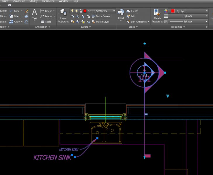

Dana W Posted September 11, 2015 Posted September 11, 2015 (edited) EDIT: This post is referring to the first block drawing you posted. I had not looked at CS_First_Test.dwg yet. [ATTACH]55510[/ATTACH] Thank you so much for your detailed feedback both, I appreciate the time you have spent to respond. Your comments make a lot of sense regarding the behaviour. I had previously made a block that worked perfectly in every way (see above) until the annotative scale was changed. They scaled up correctly except for the fact the actual line changed length too - this is why I ended up making the annotative block inside the main block. Then I realised that I needed the arrow and text to scale up relative to the end of the line on each side - this is why I put the attdef and arrow in another block. If you have any ideas on how I can allow the above block to dynamically scale the arrow and text without changing the length I would be very grateful indeed. There is a copy of an architectural style annotative section callout attached here. It comes with AutoCad. Maybe reverse engineering it can help you. You will want the arrow STEMS to change length annotatively to stay in proportion. That is one reason why we should develop an intended annotative block with the annotative scale set to 1:1 and drawn at its desired size you need it to be on the actual plotted hardcopy (or pdf). To accomplish this, annotative blocks need to be drawn in paperspace units. Your arrows are 15 + meters long. I would draw them at 30mm long +-, with a text height of 5mm to 8mm because that is how big approximately it should print in paperspace. You probably already know this but... When placing annotative objects in modelspace, first set your modelspace annotative scale to whatever scale your final plot will be for the view you are working on at the moment. (1:1000?) so the annotative block can be properly positioned at that scale, then hit the insert button. This is the same way you would adjust the current annotative scale to place annotative dimensions or multi-line text, leaders etc. Also, the distance between the arrows can be modified with a stretch action as an alternative to the move action. Using a stretch or even two can give you the option of changing the length of your arrow stems either along with the arrow separation distance or independently of the overall stretch. Section Callout.dwg Edited September 11, 2015 by Dana W Quote

Dana W Posted September 11, 2015 Posted September 11, 2015 (edited) Thanks again for the feedback. I tried Section Callout.dwg but this has the same behaviour; when you change the scale the section line changes size. Therefore if I used the section line to show a 20m section and then changed the scale it would change the length of the block. What I need is for the block to remain the same length and for the stems to change independantly. We often have to use the same plan multiple times in drawings and it is important that the block remains the same length when using different scales.I have a feeling you are expecting too much from annotative objects. They have no way of knowing how big your drawing objects are, they only know what scale to be proportional to. What you get is "the same [proportional] length". That's how annotative objects work, and why the block I uploaded has a dynamic stretch. (imperial units, by the way. Hope you caught that.) You shorten it, or lengthen it, or even adjust its position to fit the new scale. Most adjustments at one scale do not affect its appearance at another scale. You can even move them in one scale without it affecting the position in another scale, as long as you use a click and drag move. Using the move command will move the object in ALL scales at the same time. Depending on orientation of the insert point, annotative objects may or may not 'fit' the new scale in overall size, or position, but do always fit in proportional size, and can often require some manual intervention. You will also notice that using annotative dimensions can require some alignment adjustment after the scale changes. The seemingly wasted time manually adjusting some annotative objects depending on scale, is still FAR less wasted time than building or even scaling a separate object for every possible scale you might need 'someday'. As for dimensions, you can set your annotative dimension style to have Fixed Length extension lines in the dim style editor to avoid the allignment issues thst scale changes cause. If the extension lines are fixed length, for instance 1/4", the dimensions will always be offset from your "walls" or other objects 1/4" in paperspace. I have attached a screenshot of an annotative leader and annotative section callout inserted for use at 1/4" = 1'-0". I have them both selected so you can also see the ghost image of what they would look like at 1/2" - 1'-0". I have manipulated the leader so it is in a different position at 1/2" = 1'-0", but I have not changed the section callout. If you can see the ghost 1/2" = 1'-0" callout, you will see that I will have to dynamically stretch the cut line to get it through the countertop and base cabinets. (We don't normally call out detail sections of kitchen cabinets on a plan view, by the way. This is just for illustration.) You see that the insertion point for my callout, center circle, is in exactly the same place in both scales. I have not moved it yet in either scale. As for your comment regrading drawing at 1:1 - this is something I had learnt long after I made the CS_First_Test.dwg block. I now draw dyanmic blocks in Paperspace at 1:1. A lesson I learnt the hard way lol.Yeah, we all have that doctorate from The School of Hard Knocks, don't we? All one has to do is insert a 10 meter high text block in paperspace to learn that one. You do know that you can change the annotative scale for the block editor, and modelspace with that handy dandy pop-up scale list on the task bar? There's no need to go to paperspace to draw annotative objects in 1:1. It does help orient the visual size relationship to your layout, if you do use paperspace that way. Of course whatever the annotation scale is of the current view, you are still initially creating the "annotative" object in full size drawing units. Edited September 11, 2015 by Dana W Quote
