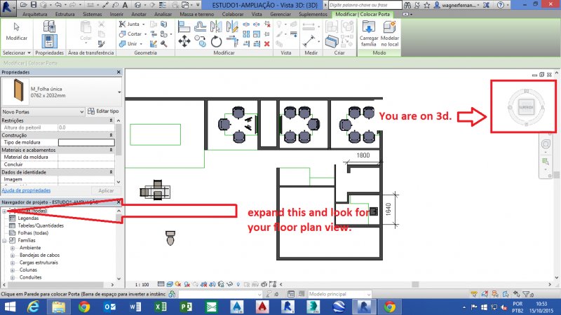

Madruga_SP Posted October 15, 2015 Share Posted October 15, 2015 (edited) Hi guys, I'm trouble to insert a door,window. I'm choosing the the families, but when I try to put it through the wall, nothing is happening. Anybody Can help me out please? Regards Edited October 15, 2015 by Madruga_SP Quote Link to comment Share on other sites More sharing options...
Madruga_SP Posted October 15, 2015 Author Share Posted October 15, 2015 Guys, I can't insert the door in the Top view. Only 3D model I can insert. I'd like to insert in Top view Quote Link to comment Share on other sites More sharing options...

tzframpton Posted October 15, 2015 Share Posted October 15, 2015 Madruga... can you give us some more detail? Possibly some screenshots? My apologies in advance but your description is very lacking. If you're in a Plan View, there should be no reason you cannot add Doors and Windows to a Wall, if a Wall does in fact exist. Are you using an architectural Link? Or are you modeling the walls yourself? Did you create a new, fresh Plan View? Have you edited the View Range at all? Is Underlay turned on, showing false positives of walls above/below? What is Revit exactly doing that will not allow you to place doors and windows, etc? Did you receive an error message? Give us some more detail and we can better assist you. Thanks in advance. -TZ Quote Link to comment Share on other sites More sharing options...
Madruga_SP Posted October 15, 2015 Author Share Posted October 15, 2015 Madruga... can you give us some more detail? Possibly some screenshots? My apologies in advance but your description is very lacking. If you're in a Plan View, there should be no reason you cannot add Doors and Windows to a Wall, if a Wall does in fact exist. Are you using an architectural Link? Or are you modeling the walls yourself? Did you create a new, fresh Plan View? Have you edited the View Range at all? Is Underlay turned on, showing false positives of walls above/below? What is Revit exactly doing that will not allow you to place doors and windows, etc? Did you receive an error message? Give us some more detail and we can better assist you. Thanks in advance. -TZ Thank you for replay Tannar, Can I import a custom template to my project? How Can I do that? I think the template is the problem, when I open a new worked fine. So I have to import the template to my drawing. Regars Quote Link to comment Share on other sites More sharing options...
Madruga_SP Posted October 15, 2015 Author Share Posted October 15, 2015 Madruga... can you give us some more detail? Possibly some screenshots? My apologies in advance but your description is very lacking. If you're in a Plan View, there should be no reason you cannot add Doors and Windows to a Wall, if a Wall does in fact exist. Are you using an architectural Link? Or are you modeling the walls yourself? Did you create a new, fresh Plan View? Have you edited the View Range at all? Is Underlay turned on, showing false positives of walls above/below? What is Revit exactly doing that will not allow you to place doors and windows, etc? Did you receive an error message? Give us some more detail and we can better assist you. Thanks in advance. -TZ I was on 3d view. If I were on 3d. You can't insert doors (etc) on top 3d view. Thank you Quote Link to comment Share on other sites More sharing options...
tzframpton Posted October 15, 2015 Share Posted October 15, 2015 Do you know the differences in Views within Revit? Here in the Help file it distinguishing them: http://help.autodesk.com/view/RVT/2015/ENU/?guid=GUID-8B1294DC-617E-48F9-AC18-A998F43384C9 I would suggest not staying in a 3D View for production work. Revit uses Plan, Ceiling, Structural, Elevation and Section Views for "production" modeling. Use 3D Views more for visualizing for now, and in time you'll understand what you can/can't do in terms of production within a 3D View. Hope this helps. -TZ *EDIT* I had the wrong link. Hopefully you didn't click the link too soon - it directed to the Developers area of Views. The link is fixed now. Quote Link to comment Share on other sites More sharing options...
