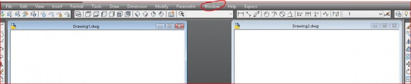

bjenk8100 Posted October 22, 2015 Posted October 22, 2015 Hello, We have access to autocad 2014 to 2016 on our machines. I am almost positive in autocad 2014 that it is impossible to view two dwg files on two different screens unless you open a second autocad application. Has this changed in the newer versions. I have looked this up and only really found the two acad applications open. It is not that much of a pain to keep two applications open but I think it would be nice so that layer, properties, tool, etc palettes do not get confusing if you dock around. Im guessing not. I saw that microstation created some new function that solved this so maybe autocad did. Greatly appreciated! Quote
Dadgad Posted October 23, 2015 Posted October 23, 2015 You can show two drawings on two different screens, by using the TILE VERTICALLY option which you will find in the Windows drop down on the Menu Bar. If you tile them vertically, you can then enlarge the Autodesk window, to create some free space between the two drawings, which will coincide with the cusp between the two screens. However, as they are both in the same workspace, your ribbon or toolbars will bridge from one screen to the other, which is less than ideal. Shown on a single screen, but the Autocad window can be situated to bridge from one monitor to the other. Quote

Dadgad Posted October 23, 2015 Posted October 23, 2015 sorry meant two different monitors. This is what goes on. I open a drawing and need another drawings that I use for reference. I copy paste somethings from similar projects. I want the one I am referencing from on one monitor and the current working model on the primary. Currently, I open autocad, get my template and get my drawing setup. I then have to open an entire new autocad application and move to another monitor. I am able to copy paste or just look at whats going on to both even though they are separate files on different complete autocad applications/monitors. Many programs allow you to minimize a drawings and move it to another screen. I just do not know why they all do not. Thanks for reply though. Understood, which was why I said..... "Shown on a single screen, but the Autocad window can be situated to bridge from one monitor to the other." As shown on one screen, but you can drag the entire Autocad window (in which they have been tiled) half way onto the external monitor, so that the unused screen space shown in my screen shot is between the two displays. In that way you WILL see dwg.1 on the left screen and dwg.2 on the right screen. Once you have done that, you still have the option of resizing the Autocad window from either of your monitors, by clicking and dragging on one of the edges or a corner. Quote

RobDraw Posted October 27, 2015 Posted October 27, 2015 I don't see what the big deal is about not just stretching the window across two screens. It can be done in a matter of seconds. Another option is to use Ctrl+Tab to quickly cycle through open drawings. Quote
