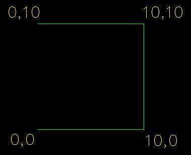

When looking at a problem posted on here recently (about marking points on a golf course...), I was thinking how I would approach the problem, and thought about using the vertices of a user-drawn polyline.
To experiment, I drew myself a polyline (attached), and performed an entget operation on it to see what it would return.
This is the result:

These coordinates correspond to the various vertices on my attached drawing. But my question is, how does one obtain these values through LISP?
My initial assumption would be something of the form:
(defun c:test (/ ent Vertex)
   (setq ent (entget (car (entsel))))
   (setq Vertex (cdr (assoc [b][color=Red]10[/color][/b] ent)))
) ;_  end defun
But how would one retrieve the next vertex, and every other vertex after that? How do you cycle through the different entries for the DXF code 10?
Many thanks for any advice and help provided :)

ASMI
Try in command line:
Click polyline to get DXF list:
Command: (setq plDxf(entget(car(entsel))))
Select object: ((-1 . <Entity name: 7efa3368>) (0 . "LWPOLYLINE") (330 .
<Entity name: 7efa1cf8>) (5 . "1AD") (100 . "AcDbEntity") (67 . 0) (410 .
"Model") (8 . "0") (100 . "AcDbPolyline") (90 . 4) (70 . 0) (43 . 0.0) (38 .
0.0) (39 . 0.0) (10 0.0 0.0) (40 . 0.0) (41 . 0.0) (42 . 0.0) (10 10.0 0.0) (40
. 0.0) (41 . 0.0) (42 . 0.0) (10 10.0 10.0) (40 . 0.0) (41 . 0.0) (42 . 0.0)
(10 0.0 10.0) (40 . 0.0) (41 . 0.0) (42 . 0.0) (210 0.0 0.0 1.0))
Remove all non 10 groups:
Command: (setq lst10(vl-remove-if '(lambda(x)(/= 10(car x)))plDxf))
((10 0.0 0.0) (10 10.0 0.0) (10 10.0 10.0) (10 0.0 10.0))
Remove first member of each list"
Command: (setq verLst(mapcar 'cdr lst10))
((0.0 0.0) (10.0 0.0) (10.0 10.0) (0.0 10.0))
Or at once:
Command: (mapcar 'cdr(vl-remove-if '(lambda(x)(/= 10(car x)))(entget(car(entsel)))))

Lee Mac
Thank you for your reply, ASMI - I have learnt a lot from it.
But, I note that this would only work for this example - for instance, if I had vertices with co-ordinates:
(1.0 5.0 0.0)
(2.0 6.0 0.0)
(3.0 7.0 0.0)
How would I deal with this situation?
Is there not a generic function for dealing with multiple occurences of the same DXF group code?
Thanks for your help ASMI, much appreciated.

ASMI
It will work with every lwpolyline.
