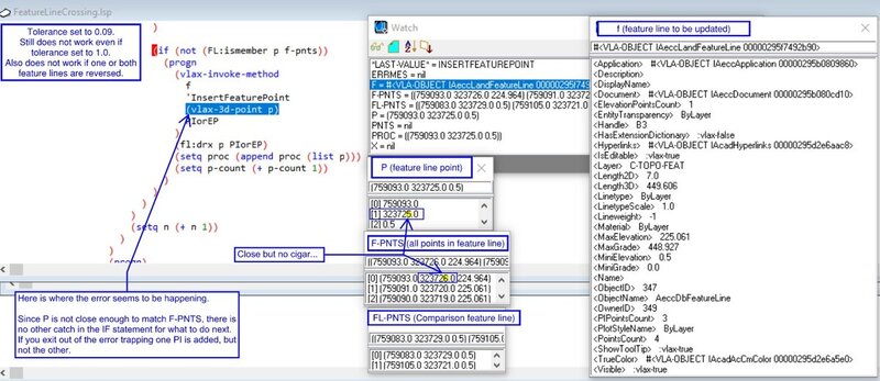

Getting this error again intermittently on some drawings - any thoughts on what could be causing it?
  • Attached:
    • Current lisp routine we've been using since 2015 with the Lee Mac/broncos15 mods
    • Drawing showing the error - reduced down to just an exact section with the issue
    • Image from Visual Lisp editor showing the last settings/variables before the error takes place
  • Troubleshooting attempts:
    • Increased the tolerance to 1.5 (was 0.09) - that did not work
    • Tried reversing one feature line, then just the other feature line, then both - all to no avail
FeatureLineCrossing.lsp FeatureLineCrossing Error.dwg
