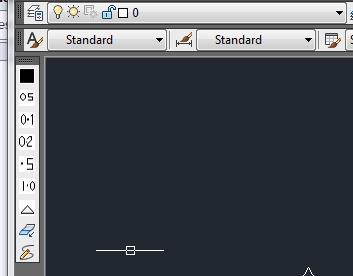

One of the ugly things in Civ3D is turning surfaces on off select etc so I wrote a toolbar interface and a dialouge selection saves going to toolspace, so in your code above a dialouge would appear to allow the setting of default surface the nice thing though is if you have only 1 surface it will set it as defualt without the need to pick. If you look at the image you can see the contours as toolbar items including the Triangles the black sq is off. Your welcome to use the code. There is a Readme in the zip.
Chcontourstoolbar.zip
