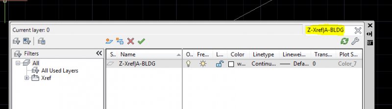

I was hoping to find something where I could pick any entity in the drawing, then have the layer name that the selected entity is on be entered into the layer property manager "search for layer" field box.
For example, say I have a line object being xref'd into a drawing and the layer its on is Z-Xref|A-Bldg
I could type the command, pick the xref'd line, then the layer name would be automatically entered into the layer search box highlighted in the attached screen shot. The layer would then be found via the search.
I've seen quite a few lisp routines that will extract the layer name that I could borrow for making this script, but I'm having trouble finding anything that could take a string and insert it into the layer search box. Is it even possible to have a lisp routine interact with the search box like that?
