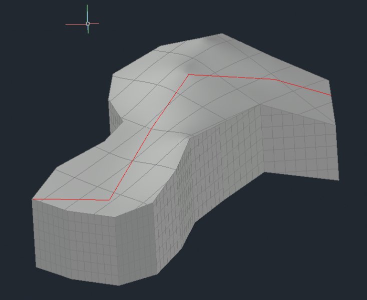

TheCADnoob Posted December 21, 2015 Posted December 21, 2015 I cant walk you there as I'm a lowly noob, but i can possibly get you some where. There a lot of 'debris' in the file. overlapped lines and what not and nodes. I cleaned these out and joined the lines into poly lines at the top and the bottom. I got rid of the vertical lines. I used SURFPATCH and select the top poly line and used the curve mode (CU) and i used the colored contour line as a guide. I did the same for the bottom. I then used loft and the poly lines at the top and bottom to create the wall. Its a shell and not a solid so this work flow may not work for you. I was having issue with the convert to solid command so perhaps some one who knows more than me can get you the rest of the way. Quote
ReMark Posted December 21, 2015 Posted December 21, 2015 If you run the OVERKILL command on the drawing AutoCAD reports back 147 duplicate objects and 15 overlapping objects. CADnoob: Is the object you created watertight? You could try using SURFSCULPT. Quote

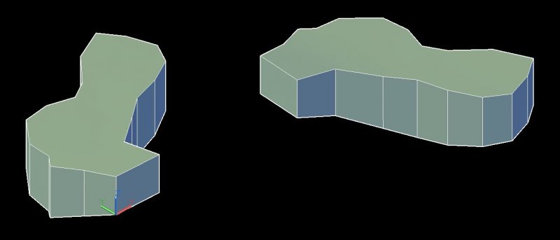

ReMark Posted December 21, 2015 Posted December 21, 2015 Here's my solid. I used SURFSCULPT to create it from the original surfaces. Quote

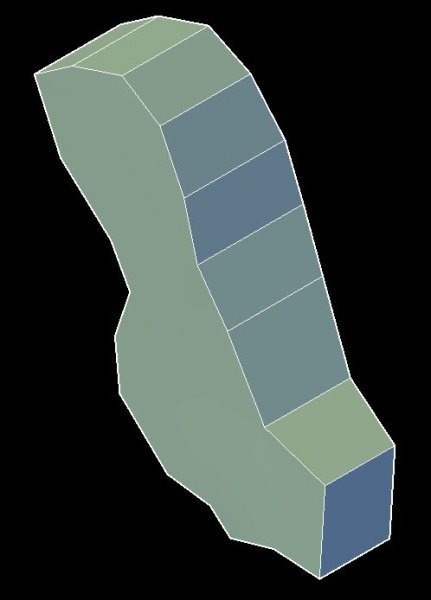

ReMark Posted December 21, 2015 Posted December 21, 2015 A couple side-by-side views of the same object. Quote
TheCADnoob Posted December 21, 2015 Posted December 21, 2015 If you run the OVERKILL command on the drawing AutoCAD reports back 147 duplicate objects and 15 overlapping objects. CADnoob: Is the object you created watertight? You could try using SURFSCULPT. Awesome! That's what it needed to complete mine, thanks. Quote

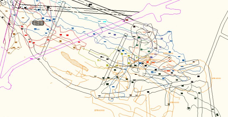

nasoox Posted December 22, 2015 Author Posted December 22, 2015 Yes, there are bunch of software for mining industry, Gemcom Surpac (50 000 euros) + you need to pay for classes to learn how to work with that program (tutorials are not complete) and still even that program cant automate this process, only pointcloud (you need a scanner to take 50K points in one session) and then t convert that in 3D or to draw with predefined profile like pipes in cad, profiles are good for coal mining, tunels are regular there, but for metal mining tunels are regular till we reach vein, then we go crazy, you've seen swiss cheese in cartoons? Much worse. Enjoy watching image of one part of our mine, there are 2 horizon's (like 2 story's in building) other 4 are on other side of map and they are about 10x bigger Quote
