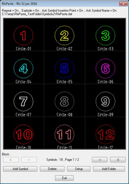

rlx Posted January 8, 2016 Author Share Posted January 8, 2016 Amazing ! ps I like a tools like this much more than pallettes. Palletes directories and maintanaces is kind of hard and tricky. I Don't like them.. Just like Lee I want to make life easier for others (only he's just a little bit more smarter than me haha). Where Lee puts a lot of effort in optimizing code (and with great succes) my goal is to minimize user interaction , if I can remove one mouse click from the process I'm happy because I have saved one cent . And further more , I try to make my code to read like a book. This means sometimes my code is not always as efficient but modern computers are so powerfull this is usually not a problem. Only when processing becomes a real problem I will put more effort in optimizing my code (if I can). And if I can't find the solution , thank the Lord for guys like Lee Gr. Rlx Quote Link to comment Share on other sites More sharing options...

rlx Posted January 13, 2016 Author Share Posted January 13, 2016 For those interested , if any , I have updated the program a little , it now includes pages and you can add an entire folder to your library / data file with the push of a button. Futhermore in the setup dialog you can choose wheter you want one big library (data file) or place the data file each in the same folder with your symbols or temporary cut copy paste stuff. Have fun gr.Rlx Quote Link to comment Share on other sites More sharing options...

rlx Posted January 13, 2016 Author Share Posted January 13, 2016 (edited) @ Rlx , your way of designing dialogs is really beautiful ,unique, and easy to read , keep it up man. That's really nice of you to say , thank you Tharwat. Actually not only do I like your coding skills too , I found one yesterday from one of your posts on how to create a table I want to study to create a table for Aloy. Just remembered , I forgot to include the option to add subfolders... awell, will do that later this week , no big deal. gr. Rlx Edited January 13, 2016 by rlx Quote Link to comment Share on other sites More sharing options...
rlx Posted January 13, 2016 Author Share Posted January 13, 2016 Just added option to include subfolders too (tested once , seems to work ... iHope) gr.Rlx Quote Link to comment Share on other sites More sharing options...
dober Posted January 14, 2016 Share Posted January 14, 2016 (edited) Unfortunately that does not work with me anymore :-( Command: RLXPASTE No slides to process Insertion point for symbol : Select objects: 1 found Select objects: Command: on the German version it is unfortunately not Danke Edited January 14, 2016 by dober Quote Link to comment Share on other sites More sharing options...
rlx Posted January 14, 2016 Author Share Posted January 14, 2016 Unfortunately that does not work with me anymore :-( Command: RLXPASTE No slides to process Insertion point for symbol : Select objects: 1 found Select objects: Command: Hi Dober , is the program using the correct data file? This really is just a simple text file with the path and name of the symbol / drawing. On way would be to delete / move / save the old data file and create a new file. Just select add folder in the main dialog , or , in the setup dialog select your data file folder. If your data file in another folder than your symbols make sure to turn of the option 'keep data file in same folder as symbols. gr. Rlx Quote Link to comment Share on other sites More sharing options...
rlx Posted January 14, 2016 Author Share Posted January 14, 2016 Unfortunately that does not work with me anymore :-( Command: RLXPASTE No slides to process Insertion point for symbol : Select objects: 1 found Select objects: Command: on the German version it is unfortunately not Danke Ach so...schade... But I'm afraid this was all my fault I had concentrated to much on the option to add a complete folder including all the subfolders that I forgot to update the add symbol function. Should have tested it better , sorry for that. I updated the lsp and the dcl file and hopefully this time it works. Gr. Rlx Quote Link to comment Share on other sites More sharing options...

rlx Posted January 14, 2016 Author Share Posted January 14, 2016 Thank going tomorrow in the company testing okidokie... just in case it has to do with maybe you having a different language (german) for AutoCad I will add ._ to all commands https://forums.autodesk.com/t5/visual-lisp-autolisp-and-general/significance-of-before-a-command-name/td-p/858269 gr. Rlx Quote Link to comment Share on other sites More sharing options...
dober Posted January 15, 2016 Share Posted January 15, 2016 Thank rlx perfect Quote Link to comment Share on other sites More sharing options...
