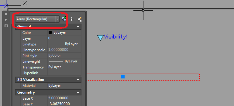

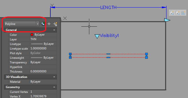

squareknees Posted January 12, 2016 Posted January 12, 2016 I have a few dynamic blocks that I have created that I need a little help with. I have a drawer front that has standard pulls I have it set to stay centered on the drawer front as I make the drawer longer or taller. I need to know how to array the pull so when the drawer front gets to a certain length it will add another pull and centers the 2 pulls on the drawer. it doesn't sound hard but I can't get it to work. I will need to know the steps so I can add the changes to the drawer top view block that I have as well. Thanks Drawer Front.dwg Quote

squareknees Posted January 12, 2016 Author Posted January 12, 2016 thanks for the help. For right now I created a wide drawer front with 2 handles, to space the handles I added a stretch variable that is .25 to one of the pulls and the other is set to .75 so they will stretch with the front of the drawer. I also made it so the drawer front can't be smaller then 24" it seems to be working but I was hoping to not have multiple drawer fronts to choose from. that is why I created the first dynamic block. I don't have a lot of time to make the corrections to the drawer front so when I get a chance I will try to add the array (which I tried). When you added array, will the arrayed pulls center on the drawer front? Thanks Quote
TheCADnoob Posted January 12, 2016 Posted January 12, 2016 so i totaly missed the point of your question but think i may have found the solution https://forums.autodesk.com/t5/dynamic-blocks/dynamic-block-how-to-keep-a-linear-array-centered/m-p/5215635#M17108 Quote
dbroada Posted January 12, 2016 Posted January 12, 2016 I don't use AutoCAD these days so can't look at what you have got but I never found a way for conditional items. One way forward might be to have 3 handles and display either one or two using a visibility parameter. Quote
squareknees Posted January 13, 2016 Author Posted January 13, 2016 Thanks CADnoob that will help a ton. I will dissect the drawing they had listed and make it work for me. Thanks again Quote
