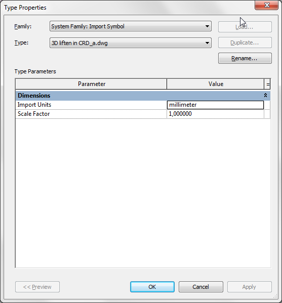

halam Posted January 19, 2016 Share Posted January 19, 2016 Today I noticed some remarkable behavior. I linked a dwg in a structural framing with shared coordinats. This is what we do more often. I noticed that the delete layer button was still active. So I 'deleted' a couple of layers like defpoints. The result was that in the revit file these layers do not show up anymore and do not display. The really good part is that (of course) Revit doesn't do anything to the dwg file inselfs. It still can be updated and in defpoints in dwg still exists. This is a good way to effectively select layers in revit (viewports) you need and can do without. Is anyone familiar with this behavior? Would AutoDesk Revit intend to change the dwg file ? Maybe the button just had to be grayed out..? Quote Link to comment Share on other sites More sharing options...
RobDraw Posted January 20, 2016 Share Posted January 20, 2016 DWG links are not a two way street. Revit pulls the data once until it needs to reload. In fact, once loaded Revit doesn't need the file anymore to show the graphics. Why would you expect the button to be grayed out? Quote Link to comment Share on other sites More sharing options...

halam Posted January 22, 2016 Author Share Posted January 22, 2016 I made a little youtube video to demonstrate how deleting layers in a linked can be used You probably get a better picture. I think 'deleting layers' comes in handy if you have only 3D DWG data from other parties you want to use. The thing i would also would be able to do is to copy a link and re-assign the path and filename. Like in AutoCAD. So using Revit there is no to have do the routine over and over again.. link DWG, import DWG, create family, link same DWG inside family for section ability, close family delete delete inserted DWG etc. to do over and over again.. (would same time) parts.dwg => in 1 family becoming part1.dwg part2.dwg copies and seperated.. If only this duplicate options wasn't greyed out.. :sad: Any idea's on that? Quote Link to comment Share on other sites More sharing options...

RobDraw Posted January 22, 2016 Share Posted January 22, 2016 If you understand what I said correctly, your "question" is answered. Maybe you are thinking that a link is like an XREF in AutoCAD. It is not. It is more like a DATALINK. It is not a "live" connection to the referenced file. What was the question? Quote Link to comment Share on other sites More sharing options...
halam Posted January 22, 2016 Author Share Posted January 22, 2016 Interesting. Revit is using a other type of linking CAD files than plain AutoCAD. What would 'delete layer' than mean keeping in mind your datalink thought..? Quote Link to comment Share on other sites More sharing options...
RobDraw Posted January 22, 2016 Share Posted January 22, 2016 Thought? I'm stating facts. Let me say it again and explain a little more detail so you can understand. Revit does not need the .dwg file once it is loaded. If I receive a model with CAD links, I don't need the CAD file. The data is stored in the model. That is why layers can be deleted without affecting the linked file. The difference with AutoCAD is that data can be written back to the linked file. If Revit did that to a .dwg, it would create a mess of it. Haven't you ever exported to .dwg? Revit does not do it well. Understand? Quote Link to comment Share on other sites More sharing options...
halam Posted January 22, 2016 Author Share Posted January 22, 2016 Link CAD really isn't linking indeed It is an import with the ability to update/refresh. Manually or at startup of the database. But my point is Revit cannot delete anything from within Revit in this mode. It remains 'global hide' method (which I like, but maybe should not have been named 'delete'...) Quote Link to comment Share on other sites More sharing options...
