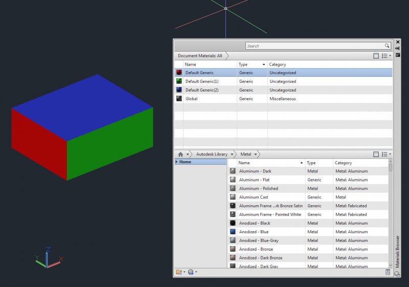

You really don't need a lisp routine for this. You can apply color to individual faces from your material editor. And by doing it this way, you will have much more control over the colors on your model. You will be able to modify or change the colors by simply adjusting the color of your materials. You can also adjust the transparency, reflectivity, change the color to a texture, apply a bump map, etc. And you can make all of these changes without having to go back and select faces again.
With your material editor already open on screen, and materials already created, do the following:
1. Click on your Solid model to select it
2. Hold down the Ctrl key and click on individual faces that you want to color
3. Click on the material in your material editor that you want to apply to the selected faces
