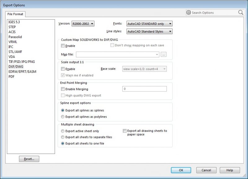

shift1313 Posted February 15, 2016 Share Posted February 15, 2016 This is the list of export options. When you chose "Save As" and select "DXF" as the file type an Options box appears. When you click that you can change a few things that might affect this(for the future). Version, which matters for what system you are going to. Line Styles, which might change the output based on what your actual drawing is. and the Spline Export Options, if you have splines and need them converted to pLines. Also in the Part file if you select a face(assuming its planar) you can right click and Export as DXF/DWG. This is usually for exporting flat pattern faces of sheet metal parts to be laser/water jet, but works on anything. Quote Link to comment Share on other sites More sharing options...
