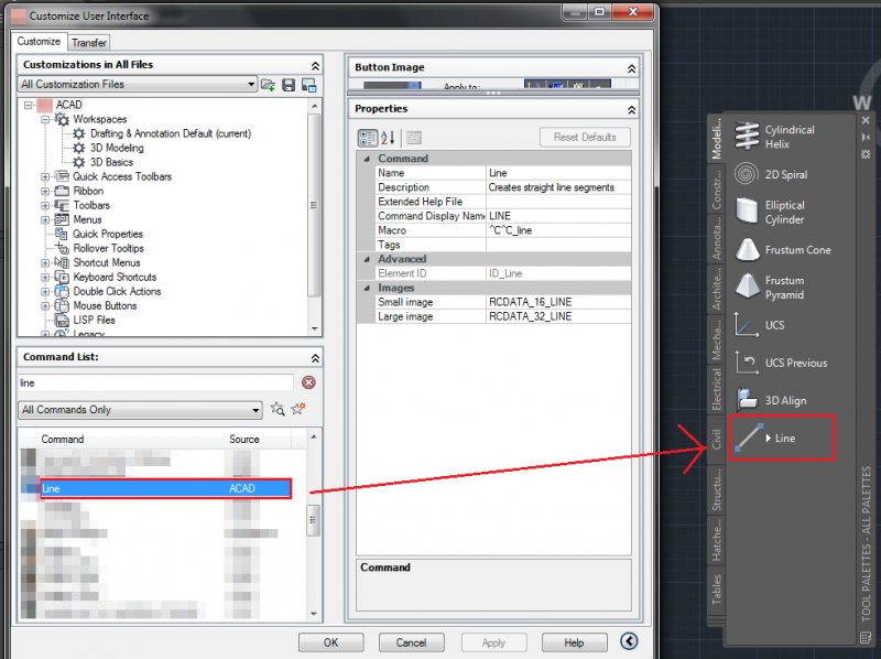

samifox Posted February 25, 2016 Share Posted February 25, 2016 HI usuing acad 2010, is there any way to copy a button (with all its properties) from ribbon to Tool Palatte? Quote Link to comment Share on other sites More sharing options...
steven-g Posted February 25, 2016 Share Posted February 25, 2016 Not directly, the toolpalette works with macros, but you can copy the macro that a button uses from the CUI and then paste it into a toolpalette command. What are you trying to achieve ? Quote Link to comment Share on other sites More sharing options...
TheCADnoob Posted February 25, 2016 Share Posted February 25, 2016 (edited) As alluded to earlier you cant necessarily do it as you describe it. you have to use the CUI type in CUI and search for the command you want and then drag it to the tool pallette and viola Edited February 25, 2016 by TheCADnoob Quote Link to comment Share on other sites More sharing options...
samifox Posted February 25, 2016 Author Share Posted February 25, 2016 as alluded to earlier you can neccearily do it as you describe it. You have to use the cui type in cui and search for the command you want and then drag it to the tool pallette and viola [attach=config]57109[/attach] you made my day:d thx Quote Link to comment Share on other sites More sharing options...

BIGAL Posted February 26, 2016 Share Posted February 26, 2016 Do the same for custom toolbars etc I use partial menus so just CUI and have notepad open copy and paste the bits like icon reference. Quote Link to comment Share on other sites More sharing options...
