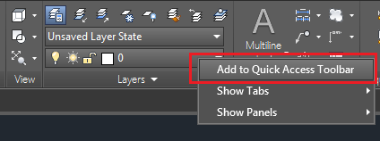

Specific to your example i have moved the layer drop down to my quick access tool bar and haven't looked back. I saw this some where and have been loving it ever since. and for giggles i added a icon to open properties next to it in the attached pic to show you can get both up there. to get the layer drop down up there just right click on it and select add to quick access. he other i added through the CUI.
