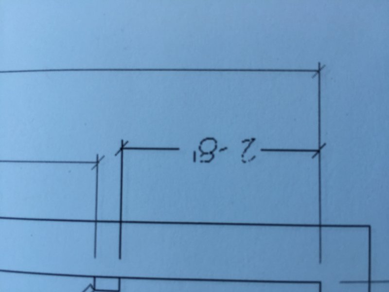

Sue g Posted March 3, 2016 Share Posted March 3, 2016 For the past month my dimensions and all of my text is printed out dotted. My line type for dimensions and text is set at continuous. Any ideas? Quote Link to comment Share on other sites More sharing options...

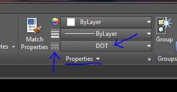

ReMark Posted March 3, 2016 Share Posted March 3, 2016 Could it be that someone (???) overrode the linetype from 'ByLayer' to 'DOT' on the Home tab > Properties panel? Quote Link to comment Share on other sites More sharing options...
Sue g Posted March 3, 2016 Author Share Posted March 3, 2016 I checked to make sure it wasn't set on dashed...it says continuous. I even tried changing it to another layer like walls which I know has a continuous line and it still prints dotted. The dimensions don't show up as dotted on my drying until it's printed. The same with my text Quote Link to comment Share on other sites More sharing options...

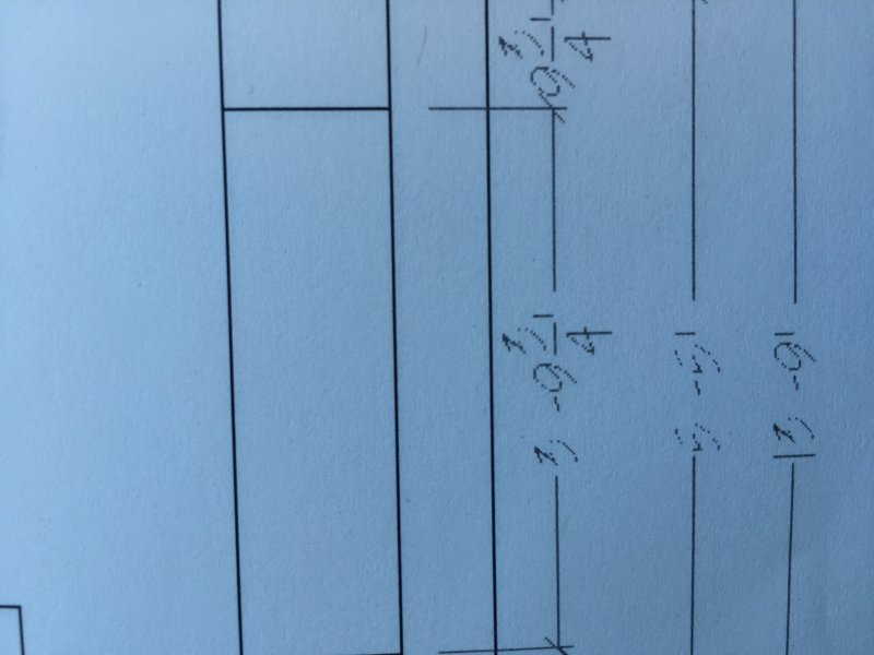

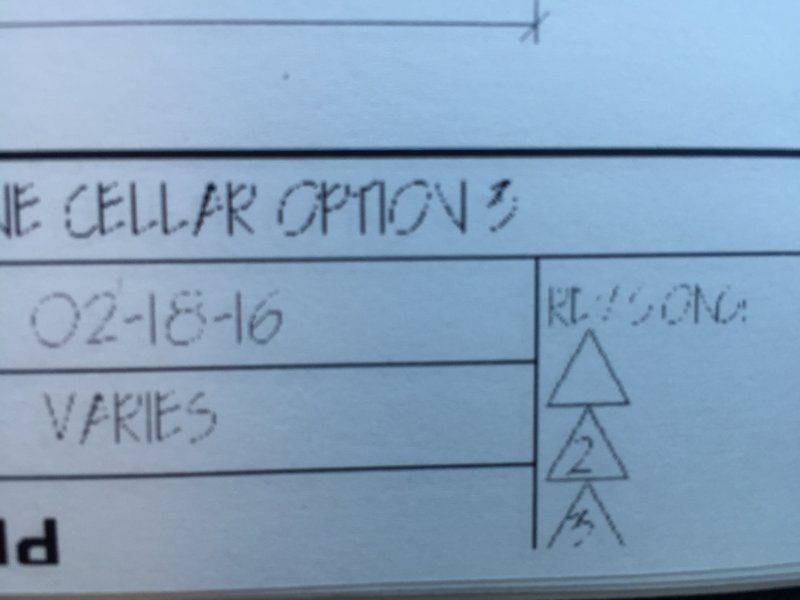

Sue g Posted March 4, 2016 Author Share Posted March 4, 2016 I've attached some pictures Quote Link to comment Share on other sites More sharing options...
ReMark Posted March 4, 2016 Share Posted March 4, 2016 OK...we believed you but we cannot troubleshoot what is happening without a copy of the actual drawing file or enough of it to demonstrate the problem. For the third, and hopefully, final time please attach a copy of the .DWG file to your next post. Thank you. Quote Link to comment Share on other sites More sharing options...
Sue g Posted March 4, 2016 Author Share Posted March 4, 2016 Here is the file KATIE W FLOORPLAN.dwg Quote Link to comment Share on other sites More sharing options...
TheCADnoob Posted March 4, 2016 Share Posted March 4, 2016 Im not getting the same results when i print. Give this a shot and see if it helps https://knowledge.autodesk.com/support/autocad/troubleshooting/caas/sfdcarticles/sfdcarticles/Text-and-symbols-are-displayed-as-dots-in-PDF.html Quote Link to comment Share on other sites More sharing options...
