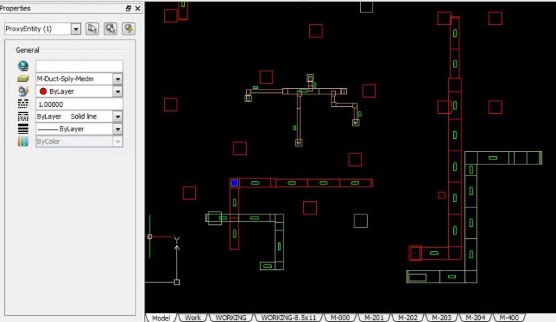

You're referring to objects such as these?
That worked. What steps did you do ReMark? Granted, I'm missing things due to a PURGE (assuming) but at least the glitch is corrected.
Update: I unloaded all of the XREF's and ran an AUDIT and saved/closed/reopened. I think the root of the issue is found in one of the XREF's.

But that is only after I already saw what I pictured above (and more).
