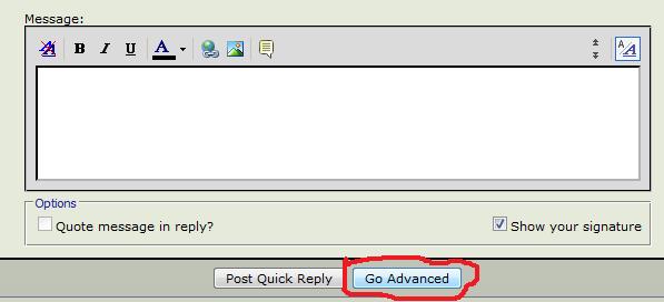

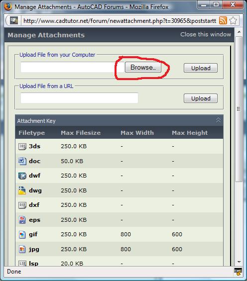

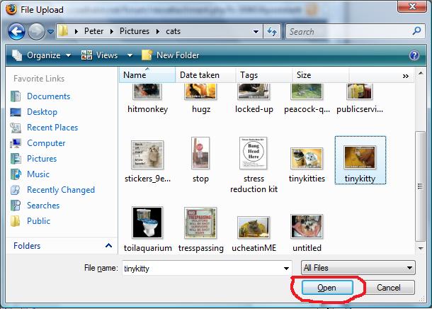

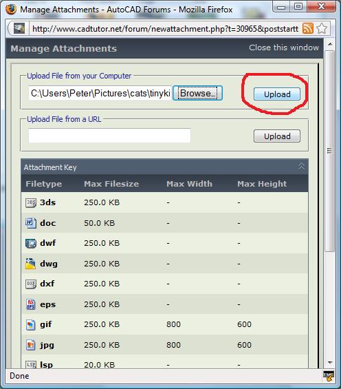

MaxwellEdison Posted January 6, 2009 Posted January 6, 2009 Click Post reply, then down under the text window theres an additional options section. click manage attachments, click browse, navigate to the file, click open, click upload, then click close this window at the top of the attachment window. Quote

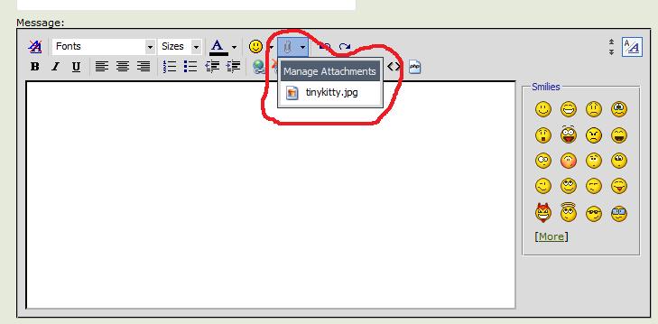

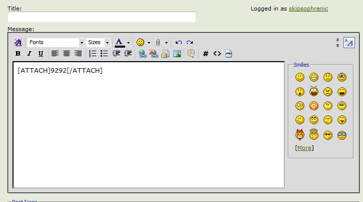

skipsophrenic Posted January 6, 2009 Posted January 6, 2009 Click "Go Advanced" Click on the paperclip icon Click "Browse" Select the file you wish to upload and click open. Click upload Click the little arrow to side of paperclip and then click on file You will then get somethin like the numbers below appear in your text window - this means the upload went ok - don't worry about the numbers, they'll appear different to mine. Quote
