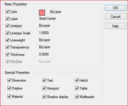

nowikovs12 Posted April 20, 2016 Author Posted April 20, 2016 Thank you that is definitely an option. I was just wondering if there is a quick way similar to the MATCHPROP which has become one of my favorite commands. Quote
Dadgad Posted April 20, 2016 Posted April 20, 2016 Yes, I really like MATCHPROP too. No doubt if you favor it, you are aware of the range of selectable options. What is stopping you from using MATCHPROP? Slap samples on a tool pallete, as ReMark suggested, drag them both into your drawing, then use those as the references for MATCHPROP. You said in your first post you wanted to switch colors as you were drawing, which was why I thought the layer switch was more fluid on the fly. I suppose you could create a couple of buttons, probably three actually, each of which would trigger a macro to change the current linetype, to whichever you want to use. Quote

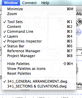

nowikovs12 Posted April 20, 2016 Author Posted April 20, 2016 cntrl+3 will toggle on or off the tool sets. and cmd+3 will toggle the command bar. I entered the CUI and created additional "empty" tool set. Is there a way to get the lines in there? I attached a snapshot of what tools I have available. Quote
Dadgad Posted April 20, 2016 Posted April 20, 2016 I just found it, knowledge.autodesk.com/support/autocad-for-mac/troubleshooting/caas/sfdcarticles/sfdcarticles/How-to-show-tool-palettes-in-AutoCAD-for-the-Mac.html I have never used AutoCad on a Mac, wish I understood the nomenclature better. I don't know what Tool Sets are, although it looks like it is something other than Palletes which are descibed lower on your dialog box. Quote
