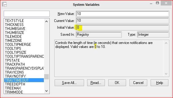

Alternately you could set your TRAYTIMEOUT system variable to 0.
Don't forgot to OK and save it to your profile.
