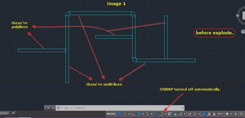

hey marko i tested your lisp & it does solve the problem of gap as mentioned earlier in the thread which is great. but there're some problems.

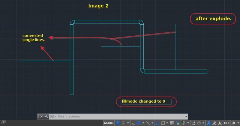

1. it creates mlines and polylines & when i explode the plines it converts them in to (1)single line.
2. it also turnsoff the Osnap & dosen't turns it back on.
3. it also changes the System Variable 'Fillmode' to 0.
i'm not complaing, just giving the feed back. if u could fix'em it would wonderfull.

Yes, I see, thanks for feedback... I hope that now it's fine... New attachment on the post where was my modification posted...

Just small mistakes : They were concerned correct OSNAP functionality... Just search in text editor for word "osmode"... On 1 place after "OSMODE" was set to 1 which is needed, "OSMODE" was set to 0 and should be (nth 3 oldVars)... Then when you continue searching, you'll find that I incorrectly wrote (nth oldVars 3) and should be (nth 3 oldVars)... That's all, but I've reattached file again...
