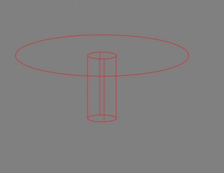

You're going to do this in 3D aren't you?

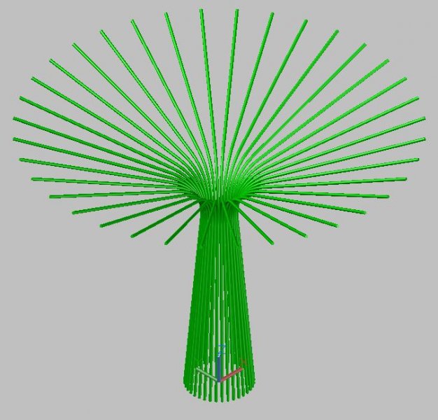

[ATTACH]58336[/ATTACH]
Awesome!!!
How could you do that?
Could you post the project?
Thanks
Use a circle and extrude or sweep it along the path of your tree profile then, as previously suggested, use the Array command, Polar option, to replicate your 3D object. Simple enough that posting the solution would be a disservice to you. Go ahead and give it a try. I know you can do it.

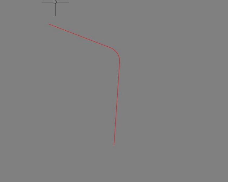

Make ONE of these using a small diameter circle and either sweep it or extrude along the path of the profile you created on layer ESTRUTURA. When done array the 3D object using the Polar option of the command.

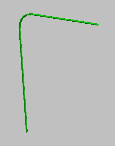

I've made one component, but I couldn't move to the top view.
I'm trying...
That looks like a 2D line you're just showing in an isometric view.
To move to the top view, go to the ribbon tab, VIEW > there's a drop down with Top, bottom, etc. views.
I would recommend that instead of using a Top view that you use one of the isometric views instead. You'll like the view better.
If he changes the coordinates by moving to a top view, he doesn't have to worry about which plane he's arraying in.
I only suggested changing the view not the orientation of his UCS.
