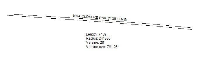

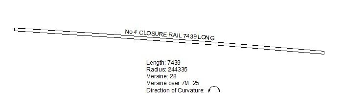

ASH71 Posted February 6 Author Share Posted February 6 Hi lads, sorry to drag this one up again. This lisp works great and I don't know if this mod / addition is possible but I have attached a sample of what the lisp does and also a sample of an additional line if it is possible - no worries if it isn't. I've just been adding the additonal direction of curvature manually. Hope this makes sense. Below is the lisp (defun c:versine ( / ang arc enx ins rad ) ;;https://forums.autodesk.com/t5/visual-lisp-autolisp-and-general/help-me-find-arc-length (defun arclen ( ent / enx ) (setq enx (entget ent)) (* (cdr (assoc 40 enx)) (rem (+ pi pi (- (cdr (assoc 51 enx)) (cdr (assoc 50 enx)))) (+ pi pi) ) ; end * ) ; end setq ) ; end defun (while (progn (setvar 'errno 0) (setq arc (car (entsel "\nSelect arc: "))) (cond ( (= 7 (getvar 'errno)) (princ "\nMissed, try again.") ) ( (null arc) nil) ( (/= "ARC" (cdr (assoc 0 (setq enx (entget arc))))) (princ "\nSelected object is not an arc.") ) ) ; end conds ) ; end progn ) ; end while (if (and (= 'ename (type arc)) (setq ins (getpoint "\nSpecify point for text: "))) (progn (setq ArcLength (arclen arc)) (setq rad (cdr (assoc 40 enx)) ang (rem (+ pi pi (- (cdr (assoc 51 enx)) (cdr (assoc 50 enx)))) (+ pi pi)) ) ; end setq (entmake (list '(000 . "MTEXT") '(100 . "AcDbEntity") '(100 . "AcDbMText") (cons 010 (trans ins 1 0)) (cons 001 (strcat "Length: " (rtos (* ang rad)) "\\P" "Radius: " (rtos rad) "\\P" "Versine: " (rtos (* rad (- 1 (cos (/ ang 2.0))))) "\\P" (if (> ArcLength 7000) (strcat "Versine over 7M: " (rtos (* rad (- 1 (cos (/ 7000 rad 2.0)))))) ; versine over 7 (strcat "") ; versine under 7 ) ; end if ) ; end strcat ) ; end cons 001 (create text) ) ; end list ) ; end entmake ) ; end progn ) ; end if (princ) ) Quote Link to comment Share on other sites More sharing options...
