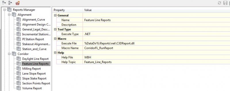

bsimpson Posted August 5, 2016 Share Posted August 5, 2016 Hi, When using the report option in Civils 3d, the report executes a number in Html with a comma in it. I can extract the comma out of the number using the MSExcel filtering options but this is laborious. How can a report number format be changed to just have a number without the comma separator? BSimpson Quote Link to comment Share on other sites More sharing options...

bsimpson Posted August 16, 2016 Author Share Posted August 16, 2016 I read a blog that changed C3dreport.dll but could not work that file on my program. When Civils3d generates a report in csv or html the commas are placed at the thousand spacers in the number and the styles and formats in Excel can't change the number and the number with the comma cannot be imported into Civils3d with the comma in it. It takes a number of calculations and formula in Excel to change the number with the comma separator to a number that can be used in Civils3d when importing as a point csv file. Quote Link to comment Share on other sites More sharing options...

MillerMG Posted August 16, 2016 Share Posted August 16, 2016 If you go into the table style settings and change the digit grouping to NOT include a comma. You should just select the one that has only numbers. Hope this helps. It fixed exactly what you were trying to change on my end. Quote Link to comment Share on other sites More sharing options...

bsimpson Posted August 21, 2016 Author Share Posted August 21, 2016 You seam to be on the right track however the command that opens the report manager utilizes a file called civilreports.dll. I cannot find the settings to remove the comma from the number. Quote Link to comment Share on other sites More sharing options...
bsimpson Posted August 30, 2016 Author Share Posted August 30, 2016 I have compressed the C3dreport.dll file below, can anyone re-write the dll file so that the digit separator is not a comma and the number reported on by civils3d can be read by MSExcel easily? C3DReport.zip Quote Link to comment Share on other sites More sharing options...
