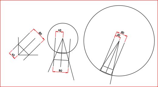

I have 2 lines intersecting at an acute angle (say 60 degrees, for example). I want to add a third line with a specific length (say 2.6 metres) perpendicular to the center-line of the other 2 lines to form an isosceles triangle. Is my explanation clear? What's the best and easiest way to add this third line? Is it possible to do without working out the trigonometry?

If the angle is a known 60 degrees, create a circle with the same radius as the length of the side you want to add, at the point of intersection of the first two lines.
That line should intersect each of the other legs at points which will define the end points of your new side. No muss, no fuss, nor tedious calculations.
But that is a one off solution, if the angle is 60 degrees only.
For any other angle, just create an angle bisector between the two lines, and offset that line by one half of the length of the new side, in both directions, it will define your endpoints for the new line.
No doubt there is a more elegant way to approach this, which I look forward to seeing, but that gets the job done, albeit somewhat tediously.

Sorry: 60 degrees was a very badly chosen example angle! :oops: I would like to know if there is a solution for any angle - say 37 degrees. :lol:
