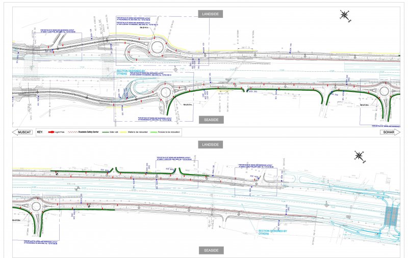

Dear Gentlemen;
I am using AutoCAD civil3d 2014
I prefer to have one more option as shown in an image below
I have more works on Plan & again Plan works as below image
thanks
Siva

sivapathasunderam
Hello anyone;
There are many drawings we need Plan views without Profile
In one sheet 2 Plans
I try using Plan only option & cut the sheet 2 Plan viewport, bring to sheet 1 bottom area, the PC get struck (not responding)
If this works for me, I can do this for same length like; 5, 10 or 20Km, but for more than these Kms not possible
Example:
1.) Street Lighting Layouts,
2.) Topographic Survey Layouts,
3.) Existing Utility Services & Proposed Relocation Layouts,
4.) Land Acquisition Plans
I look forward to hear from you
thanks
Siva

BIGAL
The only suggestion I can think of is to make all the sheets then use something like this copy layout to copy every second layout tab to the prior one then delete the blanks.
You would need a custom sheet set maker for two sheets as the viewport needs to be rotated as you walk along an alignment.
Change the paste insertion point
