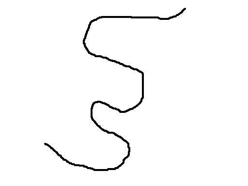

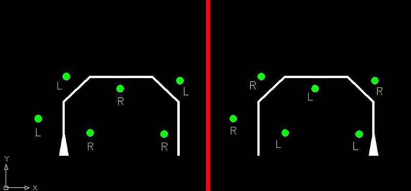

wannabe Posted January 9, 2009 Author Share Posted January 9, 2009 All it needs to do additionally is add an L or R to say which side of the track it is on. Although if you can appreciate that some roads and rails are quite twisty(think of how rivers meander), it might be more of a challenge. Maybe if you take a metre either side of the tangent point on the road or track, create a straight line, then align the ucs with that, you can use the coordinates of the block and point on the road or track to determine which side the point is on. Maybe too complex for LISP? Quote Link to comment Share on other sites More sharing options...
Lee Mac Posted January 9, 2009 Share Posted January 9, 2009 The concept shouldn't be too hard, as you already have the perpendicular point - the hard part is know which is right and which is left when the track meanders - You can't just set a rule like (if the x coordinate of the base point is greater/less than the x coord of the perp. point... etc etc then put right/left I suppose you could look at the vector from perp point to base point and check out the direction, but then the left/right issue would still be there as you would have to look at previous points to know if it was right or left. I.e. in the picture below, the direction of the track would also have to be known. Quote Link to comment Share on other sites More sharing options...
wannabe Posted January 9, 2009 Author Share Posted January 9, 2009 Well there is an up and down line for every tracl, so dont worry about which is which. Just go from left to right for this purpose. The real concern would be a road that looks like a connection of joined up S's. Quote Link to comment Share on other sites More sharing options...
wannabe Posted January 9, 2009 Author Share Posted January 9, 2009 For example. Quote Link to comment Share on other sites More sharing options...
Lee Mac Posted January 9, 2009 Share Posted January 9, 2009 True, not an easy task. Quote Link to comment Share on other sites More sharing options...
wannabe Posted January 9, 2009 Author Share Posted January 9, 2009 All I can see working is taking a 1 metre piece of track for each block and creating a straight line to set the UCS about, then comparing coordinates relative to this. If I select a fence round the objects on the left, run the lisp and then do the right side there is no problem. Unless there is some way to make 2 regions in the drawing by closing the polylines. I expect this will be easier in higher level languages, though. Quote Link to comment Share on other sites More sharing options...
Lee Mac Posted January 9, 2009 Share Posted January 9, 2009 All I can see working is taking a 1 metre piece of track for each block and creating a straight line to set the UCS about, then comparing coordinates relative to this. If I select a fence round the objects on the left, run the lisp and then do the right side there is no problem. Unless there is some way to make 2 regions in the drawing by closing the polylines. I expect this will be easier in higher level languages, though. Nice idea, but as you say - easier in higher level languages. For now I expect you shall have to select your blocks wisely. Quote Link to comment Share on other sites More sharing options...
