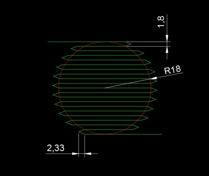

Hello,
hope that someone can help me with my request.
I want to draw a polyline over circle using 4 parameters.
Basically the user should specify the center of the circle (1) , the radius of the circle (2),the offset distance between the lines (3) and the distance to the turnaround point (4).
I am able to convert most of my ideas into lisps, but with this one I will need some guide lines. I know that it is pure math but I do not know how to express it with code of intersection points, lines, offsets...
Its doable nothing on the shelf 1st go take top quadrant pt draw a line horizontal offset down dia / number then use intersectwith to calc new pt offset down go reverse direction intersectwith and so on. 2nd go, line is tangential any angle same result.
Thinking a bit more actually need like a 2 defuns run in sequence left & right as they are two lines apart. The multiple will always be (dia/num)*2 +1 for left start right end.
You have center therefore know quadrant via simple polar need to just keep track of point swapping p1=p8 p2=p5 and so on. When I do something like this I get a bit of paper and draw object with pt numbers on it so I can keep track adding as I create then the repetition will become obvious.

Here is my version with bulges - arcs...
(defun c:snakeovercircle ( / *error* *adoc* el ci ce r n c d p k p1 p2 pl bl )

Here is version for ellipse...
(defun c:snakeoverellipse ( / *error* *adoc* el orth ell ce r1 r2 n c d p k p1 p2 pl bl )

    (cond
      ((= (rem direc 2) 0)
	(if (< direc (/ #xd-var-global-divide-nums 2.0))
	    (setq p1extend (xdrx-getpropertyvalue (list spt1 ept1)
						  "getclosestpointto" ept2 t
		  ptmid (xdrx-line-midp ept2 p1extend)
	    (xdrx-curve-setsptept e1 ept1 p1extend)
	    (if (= #xd-var-global-mode "1")
		(setq ptmid (polar ptmid 0 (distance ptmid ept2)))
		(setq garc (xdge::constructor "kCircArc3d" p1extend ptmid
					      ept2
		(xdrx-entity-make garc)
		(setq ptmid (polar ptmid 0 (* (distance ptmid ept2) 1.3)))
		(xdrx-line-make p1extend ptmid)
		(xdrx-line-make ptmid ept2)
	    (setq p1extend (xdrx-getpropertyvalue (list spt2 ept2)
						  "getclosestpointto" ept1 t
		  ptmid (xdrx-line-midp ept1 p1extend)
	    (xdrx-curve-setsptept e2 ept2 p1extend)
		(setq ptmid (polar ptmid 0 (distance ptmid ept1)))
					      ept1
		(setq ptmid (polar ptmid 0 (* (distance ptmid ept1) 1.3)))
		(xdrx-line-make ept1 ptmid)
		(xdrx-line-make ptmid p1extend)
      (t
						  "getclosestpointto" spt2 t
		  ptmid (xdrx-line-midp spt2 p1extend)
	    (xdrx-curve-setsptept e1 spt1 p1extend)
		(setq ptmid (polar ptmid pi (distance ptmid spt2)))
					      spt2
		(setq ptmid (polar ptmid pi (* (distance ptmid spt2) 1.3)))
		(xdrx-line-make ptmid spt2)
						  "getclosestpointto" spt1 t
		  ptmid (xdrx-line-midp spt1 p1extend)
	    (xdrx-curve-setsptept e2 spt2 p1extend)
		(setq ptmid (polar ptmid pi (distance ptmid spt1)))
					      spt1
		(setq ptmid (polar ptmid pi (* (distance ptmid spt1) 1.3)))
		(xdrx-line-make spt1 ptmid)
  (setq #xd-var-global-mode "0")
  (xdrx-initget 0 "0 1")
  (if (setq mode (getkword (xdrx-string-formatex
						 (xdrx-string-multilanguage "\n模式[标准(0)/圆弧(1)]<1>" "\nMode[standard(0)/arc(1)]<%s>")
						 #xd-var-global-mode
    (setq #xd-var-global-mode mode)
  (xdrx-initget)
  (xd::doc:getint (xdrx-string-multilanguage "\n等分数" "\nDivide Nums")
		  "#xd-var-global-divide-nums" 20
  (if (setq cir (car (xdrx-entsel (xdrx-string-multilanguage "\n拾取圆<退出>:" "\nPick Circle<Exit>:")
				  '((0 . "circle"))
      (xdrx-begin)
      (xdrx-setmark)
      (setq box (xdrx-entity-box cir)
	    ln1 (list (nth 3 box) (nth 0 box))
	    pts1 (xdrx-getpropertyvalue ln1 "getsamplepoints"
	    ln2 (list (nth 2 box) (nth 1 box))
	    pts2 (xdrx-getpropertyvalue ln2 "getsamplepoints"
	    an (angle (car pts2) (car pts1))
	    firstln (list (polar (car pts1) an (/ (distance (car pts1)
							    (car pts2)
						  ) 7.0
			  ) (car pts2)
	    an (angle (car pts1) (car pts2))
	    dist (/ (distance (last pts1) (last pts2)) 7.0)
	    endln (if (= (rem #xd-var-global-divide-nums 2) 1)
		    (list (polar (last pts1) (+ an pi) dist) (last pts2))
		    (list (last pts1) (polar (last pts2) an dist))
	    pts1 (cdr (xd::list:removetail pts1))
	    pts2 (cdr (xd::list:removetail pts2))
	    ents nil
      (xdrx-line-make firstln)
      (setq ents (cons (entlast) ents))
      (mapcar
	'(lambda (x y)
	   (setq ints (xdrx-entity-intersectwith (list x y) cir)
		 ints (xdrx-points-sortoncurve (list x y) ints)
	   (apply
	     'xdrx-line-make
	     ints
	pts1
	pts2
      (xdrx-line-make endln)
	    ents (reverse ents)
	    ents-pair (xd::list:snakepair ents)
      (setq i -1)
      (repeat (length ents-pair)
	(setq i (1+ i))
	(_make-sharp-corners i)
      (xdrx-curve-join (xdrx-getss))
      (setq pl (entlast))
      (xdrx-entity-setcolor pl 1)
      (xdrx-end)
The above code uses XDrx API, download link:
https://github.com/xdcad/XDrx-API-zip
https://sourceforge.net/projects/xdrx-api-zip/
Dual version link:
