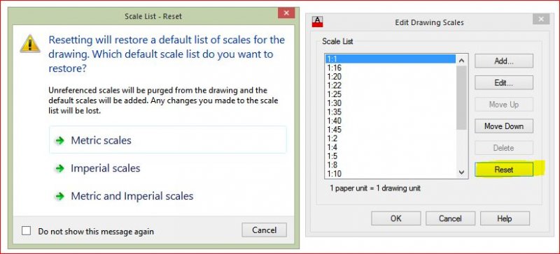

something i dont understand is the default scale list i have differs from the viewport scales list (the one with billions of scales!); can i also modify this so it only affects my pc?
2016-11-07%2015_53_45-Autodesk%20AutoCAD%20Map%203D%202014%20-%20F__Jobs_B15400_B15408_Design_Estimate_Quantities_zpssljfkzix.png
above are the metre scales i would like; is there an easy way to transfer these to my default scales rather than editing and creating them all (even though i would only have to do it once...lazy me!)
You can click into the Viewport Scales box and customize it there in the same way. As to possible confusion with your coworkers, either of the options you suggested could be fine, as long as all parties understand what is going on, and sure, it would be ideal if you showed the same scale lists, or at least use the same names, for the ones you will tend to use, to ensure consistency.

Once you have set up your Default Scale List how you like it, you can click into the Viewports Scale box, which will open the dialog you used when tweaking your personalized settings, and RESET, at which point it will look just like your default list. You will be offered the Metric, Imperial or Metric & Imperial default lists from which to choose. Glad I could help you. :beer:

ha ha... exactly what i have just done! also added in the 1:1 plot and 1:2 plot scales.
very happy - big thanks. :)

Likely the only reason those extra scales are there, is that nobody has ever been offended enough by them, to investigate a bit, and find the RESET option.
They are now a thing of the past, there is no time like the pleasant.
