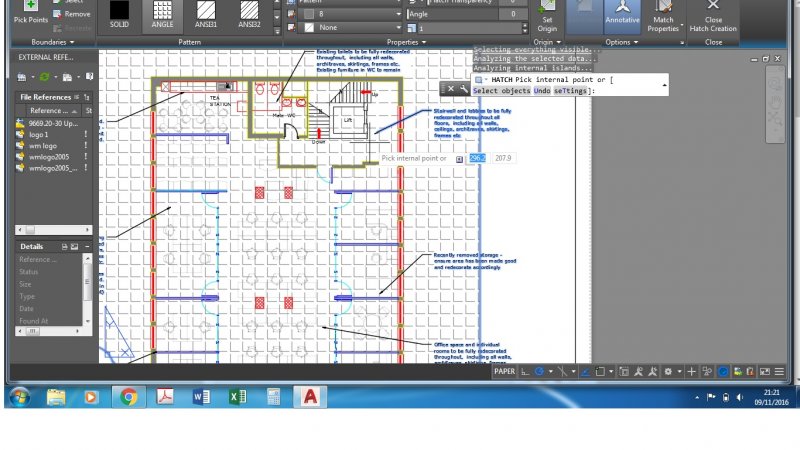

fattony Posted November 9, 2016 Author Posted November 9, 2016 One step at a time, if I may start with hatching, this is my process: 1) Open the file 2) Select Hatch 3) Pick Pattern & Colour 4) Select 'Set Origin' 4) Highlight the area I want hatched And this is my result (attached) DWG is here https://www.dropbox.com/s/xhangq3h95oxch7/9669.20-30%20Upper%20floors%20-ASBUILT.4.3.16.dwg?dl=0 Appreciate any help you can give, we have a CAD guy but sometimes when you want to make a couple of simple changes and he's busy for 2 weeks its frustrating so I wanted to see if I could edit some bits myself Thanks Quote

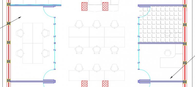

ReMark Posted November 10, 2016 Posted November 10, 2016 Re: Hatch pattern. Were you attempting to do something similar to what I did for the office to the right? I used the hatch pattern you already selected. What is the basis for using this particular pattern? It seems kind of "busy". Quote

hakmawongzi Posted November 12, 2016 Posted November 12, 2016 1. Open both drawing and copy & paste bewteen the two. 2. Only copy the individual floor plan and you will be able to hatch individual area of the plan. Seems like you were hatching the large rectangle enclosing all the floor plans. Quote
fattony Posted November 14, 2016 Author Posted November 14, 2016 Struggling with hatch, I can switch off layers and delete stuff I dont need but cant hatch. Ive tried clicking hatch then select and draw in a section I would like hatched but it doesnt display I then tried clicking hatch then pick point and click in the floor plan but the entire page gets hatched Is it really that tricky? Quote
