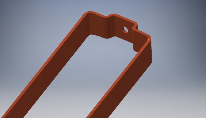

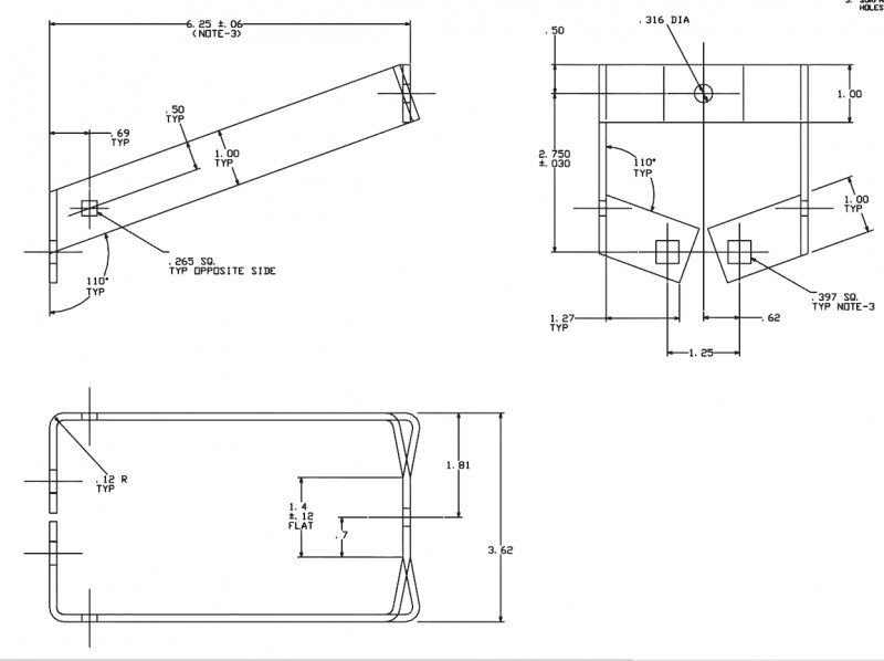

mandrews Posted November 17, 2016 Share Posted November 17, 2016 Hi all, I am a little stuck on this sheet metal part I am trying to recreate from a 2d drawing. So, the part that I am having issue on is the transition, pretty much a twist feature. This is my most straightforward approach at modeling this to match the drawing and get a flat pattern for the drawing. I was hoping that the lofted flange would take care of this situation, but find it troublesome. I have attached the part that I have so far. I left the last loft in there, that would be close to what I am trying to achieve as I believe this is what the part looks like. However, when I tried to add a bend, it errors out. If there is a better or more direct way, I'm all ears. Thanks, Matt sm-stuck.ipt Quote Link to comment Share on other sites More sharing options...

kpyoung333 Posted November 23, 2016 Share Posted November 23, 2016 That is a tricky little part indeed. The bottom and sides are easy enough, the twist is a bit annoying. I tried to use a Loft as Surface, Thicken, but it skews the edges away from the side and middle then doesn't flatten. Using a regular Loft works just fine but that doesn't flatten right either. Was thinking about a 3d sketch that could be swept along a line but now we're just getting crazy, I might try it... Attached is a good enough model that flattens but still has the little twist. For manufacturing I would use the overall length, find the angle locations and note that you need a 20° twist, not sure if inventor has capability to calculate that for sheet metal but such is life. mandrews1.ipt mandrews1.pdf Quote Link to comment Share on other sites More sharing options...

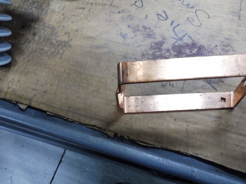

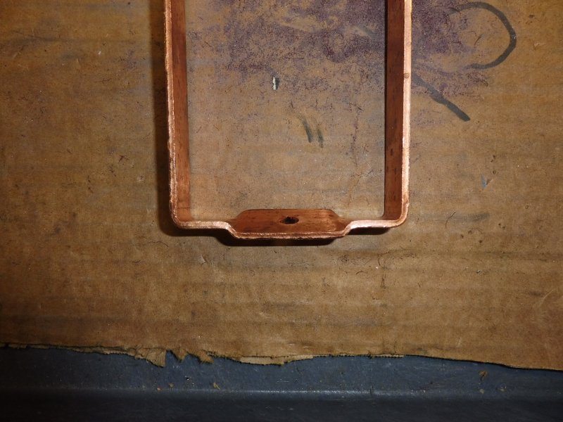

mandrews Posted November 29, 2016 Author Share Posted November 29, 2016 This part is is tricky, I wish I had the physical part in front of me. However, it's in another location, so I have some pictures, and it definitely cleared things up for me when I saw the pictures. kpyoung333, that was the path I was going until I saw the pictures. The pictures showed me that it was a twist. I posted this over on the autodesk forum and they let me know that the twist would not be possible in inventor today. So, for the time being, I have put in a couple bends and the part will work in the assembly, but the part is not accurate. Quote Link to comment Share on other sites More sharing options...

JD Mather Posted January 31, 2017 Share Posted January 31, 2017 No, I haven't put much time into this since my last post. Modeling an accurate (3D) finished part is not an issue. The real issue is that Inventor will not return a flat pattern because of the twist. Quote Link to comment Share on other sites More sharing options...
