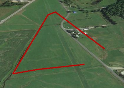

lrm
Another approach would be to create a KML file that can be displayed in Google Earth. You can then adjust the Google Earth view to something you like and save an image of it.
If you can get the latitude and longitude of piping corners you can create a simple file that shows the piping laying on the surface of the Earth. You can create the file in Notepad or another ASCII text editor.
Here is an example of a kml file:

Just replace the list of latitude and longitude coordinate in the above code with your coordinates. Also change the values in the LookAt section with values suitable to your location. These values determine the initial view of the data when you open the file in GE.
I set the altitude mode to "clampToGround". This places the lines on the ground and ignores the altitude value. I tried using the absolute mode and setting a negative altitude but the lines would not show.
