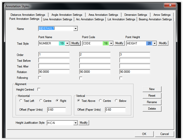

BIGAL Posted December 9, 2016 Share Posted December 9, 2016 1 thing to watch out for when converting text is where is the text relative to the point, if you use insertion point say bottom left but we can make text so the decimal point is the actual point location so a x,y error. To get around this just check and move "all" text if required before making 3d points. Most times its better than nothing. Quote Link to comment Share on other sites More sharing options...
Roy_043 Posted December 9, 2016 Share Posted December 9, 2016 so the decimal point is the actual point locationWhat do you mean by 'decimal point' here? Quote Link to comment Share on other sites More sharing options...
BIGAL Posted December 10, 2016 Share Posted December 10, 2016 Our other civil software can place the text say 123.456, the actual survey point lines up with the decimal point 123X456 so the insert point lower left is offset from the true location of the point. A very slight error in the x,y. I have had text come in like a metre away from the actual survey point its all about how it was created. I have 30 years doing this. Quote Link to comment Share on other sites More sharing options...

BIGAL Posted December 12, 2016 Share Posted December 12, 2016 No worries. Thanks hanhphuc went looking for a sample as well I have seen text 750 mm away from actual survey point. The 52mm error is probably acceptable when you are starting with nothing. This is the screen for our other software note the horizontal offset value. Quote Link to comment Share on other sites More sharing options...
