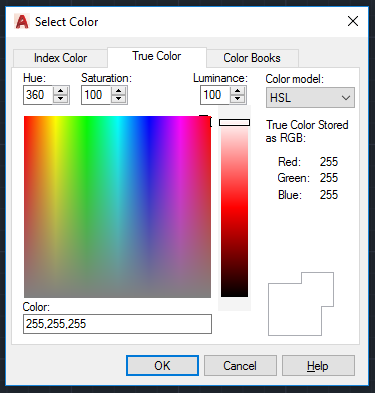

rkent Posted December 13, 2016 Posted December 13, 2016 Yes, it still prints white rather than invisible. It acts as a wipeout for anything beneath it. Tried doing it with plotter settings on "lines merge" instead of overwrite, and still can't get it. Does it work for you? Make sure you are using color 255,255,255 and not 255. With 255,255,255 and line merge it works just great here. HP wide format color plotter. Quote
tzframpton Posted December 13, 2016 Posted December 13, 2016 Make sure you are using color 255,255,255 and not 255. With 255,255,255 and line merge it works just great here. HP wide format color plotter.To fully iterate rkent's suggestion, attached is a screen shot. Quote
