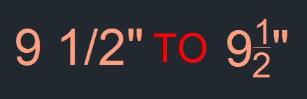

Dear Marat friend,
your macro is great working. especially GUI is awesome. my final request is if any possibilities, please tweak half inch display text format as shown in image.
Thank you for helping.

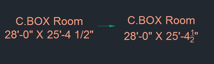

hi friend,
thank you for valuable reply. i apologies for inconvenience caused. here i have attached sample out put format. your previous version is enough (post#10). i have requested only vertical format (stacked format, it is showing option at medit window, by manual editing). please tweak when you have free time only.
Thank you for support.
See version 3
Thank you for yours valuable modification. some gap is formed as mentioned in picture. please modify.
sorry for asking modifications.
thank you.
Again sincere thanks to you friend,
still facing space issue by out put text, minor error. here i have attached image. please have a look.
Thank you for great contribution.
Thank you my dear friend,
now its perfectly working. o:):D
