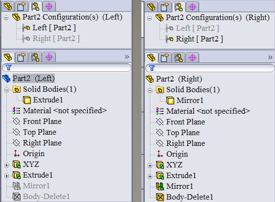

jkristia Posted January 10, 2009 Share Posted January 10, 2009 I'm sure there is a simple solution to this, but I just can't find it right now. The question is how do I mirror a feature and suppress the 'source' feature. Im drawing the side walls for a wall cabinet and I would like to define the left and right side in the configuration and then simply mirror the grove on the back from left to right. I know of course that I can save the cut as a sketch block then create a second sketch with the block mirrored and then suppress the left feature, but isn't there another way to do this ? Jesper Quote Link to comment Share on other sites More sharing options...

cedar Posted January 12, 2009 Share Posted January 12, 2009 When I have left-right versions I finish the entire part… then mirror the BODY. Uncheck “Merge” so you have 2 separate bodies. Delete the first body so you just have opposite part. Configure that. Activate the original config and suppress the mirror. Quote Link to comment Share on other sites More sharing options...
jkristia Posted January 14, 2009 Author Share Posted January 14, 2009 oh, I wasn't aware of the Body-Delete feature, perfect that is exactly it Thanks Jesper Quote Link to comment Share on other sites More sharing options...
