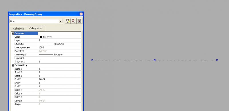

eldon Posted January 24, 2017 Posted January 24, 2017 To match the line-dash spacing of the line in your drawing (length 54627 units with linetype HIDDEN2), I had to set the linetype scaling at 1000. Quote

tive29 Posted January 24, 2017 Author Posted January 24, 2017 To match the line-dash spacing of the line in your drawing (length 54627 units with linetype HIDDEN2), I had to set the linetype scaling at 1000. Huh? In my attach dwg, the dash can be seen at global linetype scale 1. Edit You mean the object linetype scale or global linetype scale? Quote

eldon Posted January 24, 2017 Posted January 24, 2017 Huh? In my attach dwg, the dash can be seen at global linetype scale 1. Yes, but individual linetype scale of 10. I was just proving the point that your drawing has some other scaling going on, because you had not started the drawing from scratch. EditYou mean the object linetype scale or global linetype scale? It doesn't matter with one line Quote
eldon Posted January 24, 2017 Posted January 24, 2017 Weird. Cause The drawing is from autocad created template....... which is not the same as starting a drawing from SCRATCH. Never mind, you have your problem sorted. Quote
tive29 Posted January 24, 2017 Author Posted January 24, 2017 which is not the same as starting a drawing from SCRATCH. Never mind, you have your problem sorted. Weird. Cause The drawing is from autocad created template. Here is how it looks on my end Quote

eldon Posted January 24, 2017 Posted January 24, 2017 It is always a bit of a challenge to explain why AutoCAD is apparently working in different ways, so I thought that I would go back to basics. This is the line definition of the linetype HIDDEN2 in acadiso.lin. The figures mean that there is a line of 3.175 units followed by a space of 1.5875 units. ;; ;; AutoCAD ISO Linetype Definition file ;; Version 2.0 ;; Copyright © 1996 - 2004 by Autodesk, Inc. ;; ;; customized for ISO scaling ;; *HIDDEN2,Hidden (.5x) _ _ _ _ _ _ _ _ _ _ _ _ _ _ _ _ _ A, 3.175, -1.5875 If I examine the dash - space pattern of your posted line, then ignoring the two end lines, the dash length is 3175 units and the space length is 1587.5 units. This to me suggests that the linetype scaling is 1000. Perhaps your architecture variety of AutoCAD is given some hidden scaling effects, unless AutoCAD has rewritten the linetype definitions. Perhaps your interest has waned in the meantime. Quote
tive29 Posted January 24, 2017 Author Posted January 24, 2017 I am keen to know more eldon. How did you get the measurements for HIDDEN2? I certainly gain a better understanding. Quote
eldon Posted January 25, 2017 Posted January 25, 2017 I am keen to know more eldon. How did you get the measurements for HIDDEN2? I certainly gain a better understanding. The file containing all the standard AutoCAD linetype definitions is called acadiso.lin (for metric linetypes), and I usually do a search in Windows to find it. To actually measure the dashes and spaces in the drawing, I opened the drawing in DWG TrueView, which showed your line. I turned off the ObjectSnap, and zooming in, I eyeballed the required distances. This is not exact but will give me the "order" of the lengths, and do not use the first and last dashes which make up the line length. I actually measured 3183.4 for a line and 1573 for a gap. When one compares this with the linetype definition file, it is easy to see what it should be (assuming that the scaling is exactly a factor of 10). Obviously there is another scaling factor working in your drawing and template, which may give you the line-dash pattern you are used to. But if the drawing is converted to a version that I can open up (version 2000), this extra scaling factor disappears. Quote
