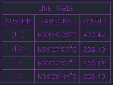

In the survey business, here in Texas anyway, we do LOTS of record information ( ) and adjoiner record information [ ]. I'm trying to either create a table, in the general format shown in the image attached BUT I'd like the order of the line numbers to be L1, then (L1), then [L1] (if applicable), so on and so forth. Currently I only have the option to sort data based on ascending or descending. I've looked in all of the table options and I'm not seeing anything that will allow me to do this. Any help is appreciated.

A crude way may be to read the table into a list and hopefully Lee will read this and sort the list recognising the "(alpha" v's "alpha". Then rewrite the table in the new order. It may need a non display character so like above you have 3 characters to sort on.
This is what I was thinking too but I have no clue how to make it happen.
Maybe a column on the left that is used for sorting only. A dynamic block perhaps?

I'm not sure of the intended sort order, but the following function demonstrates a sorting method:

The order I'm looking for is: A1, (A1), [A1], B2, (B2), [b2], etc
The table image shown in the original post gives an idea of what I'm dealing with using a LINE TABLE from Civil3d. When doing a parcel the user has the bearing & distance (B/D) of the subject line, the record B/D of the subject parcel ( ) and then the record B/D of the adjoining parcel [ ]. So when sorted, I'd like to have the first line number be without parenthesis or brackets, the next with parenthesis and the next with brackets, then that same order repeated for the next line number(s).

Thanks - here is a refinement of my earlier function to yield the required sort order:
Is a 'Line Table' a type of object native to Civil 3D? Or does it appear as a standard AutoCAD table and 'Line Table' describes the table content in this context?
Are you able to upload a sample drawing containing a typical example of such a table?
