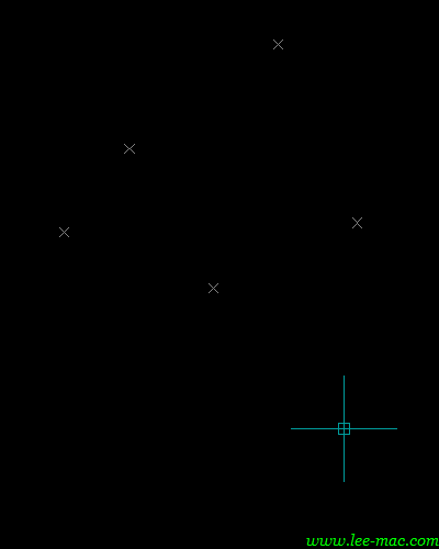

Before posting here, I considered before if the central point should come first or last. I choose last as it allows more flexibility to place the central point as it needs to be in relations to the other clicks.
tive29, study the variable BLIPMODE... Second Tharwat's code is just fine, just implement BLIPMODE inside code (use getvar to store default value at the beginning, set it to 1, and at the end restore stored value from beginning)...
