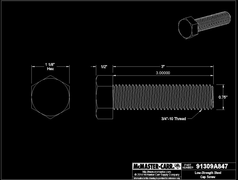

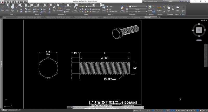

xoHaya Posted May 2, 2017 Posted May 2, 2017 Hi, So I downloaded a 2D plan of a fastener from McMaster-Carr. I copied and imported it in a new drawing (to see the difference). I want to use it to make a simplified representation and an assembly drawing. However, the drawing does not seem to be at a 1:1 scale. I can't figure out how to know what scale it is on the use the scale command to factor it. Is there a way I can convert it to a 1:1 scale? If i change the dimscale/style it changes but, the drawing is still off. I attached a screenshot of what I mean. The length is supposed to be 3'' but when I measure it it's actually 4.5''. The length is supposed to be 3'". I want to draw in the same scale as the drawing. Thank you for your time, if I'm not clear please tell me, it's my first post. Quote
SLW210 Posted May 2, 2017 Posted May 2, 2017 Yes, it happens occasionally with their files. Use the Scale>Reference option. Quote
Dana W Posted May 2, 2017 Posted May 2, 2017 Is the 4.5 the only dimension that is wrong? Can you upload the drawing so we can examine it? If one or more of the other dimensions are correct, it could be that the bolt is simply drawn incorrectly. EDIT: Also, SLW might have nailed it. I have seen some of their drawings with a few of the dimensions overridden. Somebody doesn't see the point of changing the geometry to match only one dimension. If I had to draw a few dozen bolts which only vary in length I could see why. Quote

SLW210 Posted May 3, 2017 Posted May 3, 2017 I went and got that file from McMaster-Carr and mine is properly scaled. Can you upload the .dwg you got from McMaster-Carr? 91309A847-.75-10 x 3 HHCS.DWG Quote
xoHaya Posted May 3, 2017 Author Posted May 3, 2017 Thank you all for your answers! Here is my file to show what i mean. The dimensions I took are in red. Half the dimensions are good.. the other half are off. So I just have to modify the drawing, it has nothing to do with the scale? McMaster Prob.dwg Quote
ReMark Posted May 3, 2017 Posted May 3, 2017 They aren't off. Maybe it's the fact you have the precision for dimensions set to two decimal places and not three. Quote
xoHaya Posted May 3, 2017 Author Posted May 3, 2017 Oups! you are right! sorry! let me get the file I was working with yesterday! Quote
xoHaya Posted May 3, 2017 Author Posted May 3, 2017 PROB.dwg Here we are. So if i draw a line of 3", it makes a line of 2" ? Quote

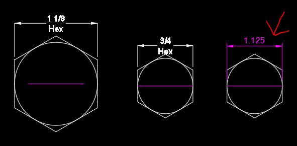

ReMark Posted May 3, 2017 Posted May 3, 2017 Who was it that applied a measurement scale factor, in the dimensions style dialog box, of 0.666666666667? Was it you? I think someone scaled the parts up (1.5004444X) then to get the correct dimensions they changed the measurement scale factor to the value previously mentioned. Who did it or why is a mystery to me. Quote

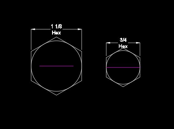

ReMark Posted May 3, 2017 Posted May 3, 2017 First image shows the hex head as it originally appeared and after it has been correctly resized to the proper width of 1.125". However, since the measurement scale factor of 0.66666666667 has not been changed it is dimensionaly incorrect after the rescaling. Quote
ReMark Posted May 3, 2017 Posted May 3, 2017 Second image shows what happens after changing the measurement scale factor back to "1" which it should be. Quote
xoHaya Posted May 3, 2017 Author Posted May 3, 2017 Yes thank you ! that fixed it ! Is it possible that because I copy/pasted 2 drawings together the dimstyles were modified? because I didn't change the measurement scale. Quote
