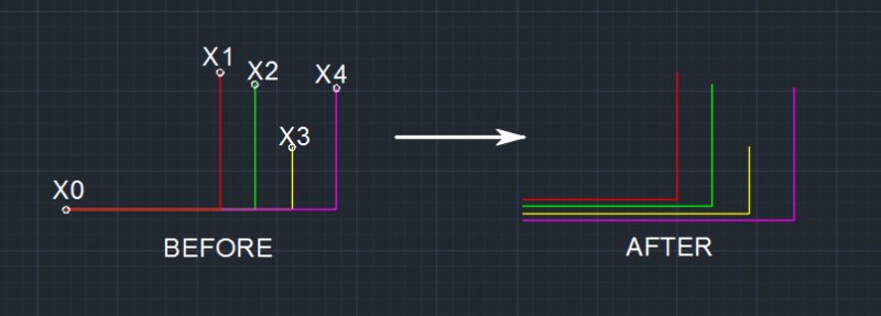

Greetings everyone ...
iam looking for a way to solve this problem
i have a lisp that conncect multiple blocks to one base block in the drawing
... it will draw polylines as the case called "before" in this attached image
the resulted polylines will coincide at the base point ...
so i want to sort these polylines by there dist=(Xn-X0) distance
so that the polyline with the smaller dist will be offseted higher and so on ...
only the coincide segment will be offseted ... X1 TO Xn will keep their locations
any suggestions ?
thank you in advance
Getting the order is easy if you use ssget "F" fence option and drag over verticals it will select them in correct order.
(setq lst (list (getpoint"pick left") (getpoint "Pick Right"))) ; pick left and right
(setq ss (ssget "f" lst)) ; make selection set
(setq obj (ssname ss x)) ; x starts at 0 and is (- (sslength ss) 1) long
What appears to me is to offset plines down then reset the last vertice Y value. I dont have anything right now so may post later on.
iam working to modify this lisp

to help me to reach to my goal .... can you please modify it for me so that it accept a selection set from another lisp
i use "SS1" to get SELECTION SET OF these polylines
                    (setq bbx (LM:blockboundingbox (vlax-ename->vla-object ss0)))
                   (setq ss1
                       (ssget "_C"
                           (trans (car   bbx) 0 1)
                           (trans (caddr bbx) 0 1)
                          '((0 . "ARC,ELLIPSE,CIRCLE,LINE,XLINE,SPLINE,*POLYLINE"))

Mine is way shorter please test it seems to be working for me only 1 bug plines must go left to right. But that could be solved.
; adjust pline vertical only and maintain last point
; By Alan H
(defun c:test ( / x newpts obj j yval incy)
(setq incy (getreal "enter offset +ve or -ve"))
(setq pt1 (getpoint "pick 1st point"))
(setq lst (list pt1 (getpoint pt1 "get 2ndpoint")))
(setq ss (ssget "F" lst))
(setq yval 0)
(repeat (setq k (sslength ss))
(setq yval (+ incy yval))
(setq obj (vlax-ename->vla-object (ssname ss (setq k (- k 1)))))
(setq pts (vlax-get obj 'coordinates))
(setq newpts '())
(setq x 0)
(repeat (- (/ (length pts) 2) 1)
(setq newpts (cons (nth x pts) newpts))
(setq newpts (cons (+ yval (nth (+ x 1) pts)) newpts))
(setq x (+ x 2))
(setq newpts (cons (nth (+ x 1) pts) newpts))
(vlax-put obj 'coordinates (reverse newpts))
Edited by BIGAL

... this is a good strat for me to reach to my goal ...
if you can fix the bug polyline it will be great ... anyway thanks for your time and good lisp
thanks mr.BIGAL
The solution to the pline direction would require possibly an extra pick pt or maybe use pt1 to compare start and end pts distance from the point1 so if end is shorter use reverse on the pline and maybe re do the selection set. If you run the lisp and one comes out wrong do a undo "U" till back to original and do a "REVERSE" on the pline/s that came out wrong then do again and all should be good.
; a sample reverse pts check swap start and end
(setq d1 (distance pt1 pt3))
(setq d2 (distance pt2 pt3))
(if (> d1 d2)
(setq temp pt1)
(setq pt1 pt2)
(setq pt2 temp)
