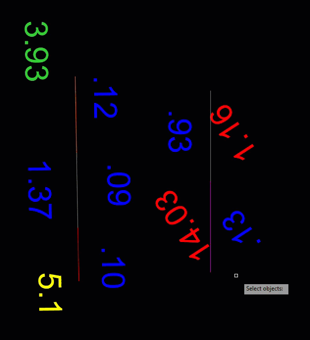

Align text to nearest line.
aawilds
My boss may have just asked for the impossible, but he wants a lisp to be able to window select multiple text then window select lines near the text, and have the text align to the line or polyline that is closest to the text. I have something that allows me to pick a line then a text, but I have no idea how to do this. Any help is greatly appreciated, this is way above my ability. The attached pictures show before and after.

ronjonp
I had looked at that Lisp by Lee mac. It is good, but I need to be able to select multiple text that are already in the drawing, and them be aligned to the nearest line. Without having to pick individually.
Give this a try:
(defun c:foo (/ a l lines p ss text)
 (if (setq ss (ssget '((0 . "Line,Text"))))
   (progn (foreach x (vl-remove-if 'listp (mapcar 'cadr (ssnamex ss)))
     (if (= "TEXT" (cdr (assoc 0 (entget x))))
       (setq text (cons x text))
       (setq lines (cons x lines))
   (if lines
     (foreach x	text
       (setq p (cdr (assoc 10 (entget x))))
       (setq l (car (vl-sort lines
			     '(lambda (a b)
				(< (distance p (vlax-curve-getclosestpointto a p))
				   (distance p (vlax-curve-getclosestpointto b p))
       (setq a (angle (cdr (assoc 10 (entget l))) (cdr (assoc 11 (entget l)))))
       (entmod (subst (cons 50 a) (assoc 50 (entget x)) (entget x)))

aawilds
That works for the most part. Is there any way to get it to work with polylines?

BIGAL
The answer for plines is you can get closest point to and then do a "first derivative" which will allow you to work out an angle for the text. look at this bit of code.
(defun alg-ang (obj pnt)
 (angle '(0. 0. 0.)
    (vlax-curve-getfirstderiv
      obj
      (vlax-curve-getparamatpoint
        obj
        pnt
Share this post

ronjonp
It's very easy to include polylines, but your initial question only asked for lines and text. With the code provided, just explode polylines and it should work per the initial request.

ronjonp
Here's a version that will work with polylines too:
(defun c:foo (/ _aap l lines p p2 ss text)
 ;; RJP - 6.14.2017
 (defun _aap (ename pt / param)
   (if	(and (not (vl-catch-all-error-p (vl-catch-all-apply 'vlax-curve-getendparam (list ename))))
     (setq param (vlax-curve-getparamatpoint ename pt))
     (angle '(0 0) (vlax-curve-getfirstderiv ename param))
 (if (setq ss (ssget '((0 . "*polyline,Line,Text"))))
   (if lines
     (foreach x	text
       (setq
	 l (mapcar
	     '(lambda (x)
		(list (setq p2 (vlax-curve-getclosestpointto x p)) (distance p p2) (_aap x p2))
	     lines
       (setq l (car (vl-sort l '(lambda (a b) (< (cadr a) (cadr b))))))
       (entmod (subst (cons 50 (caddr l)) (assoc 50 (entget x)) (entget x)))
