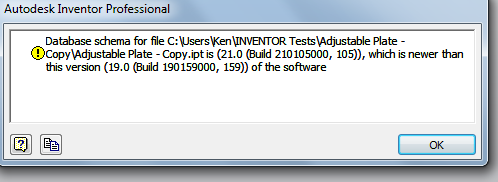

vertical horizons Posted June 25, 2017 Author Posted June 25, 2017 Well, I downloaded the zip file, extracted it & attempted to open it. I got this error message instead. Anyone have any idea as to how to get around this "newer version" issue to get the .ipt to open? (BTW, I am running Inventor Pro 2015.) Quote

shift1313 Posted June 26, 2017 Posted June 26, 2017 sorry for the delay. I don't know of any way you can open the 2017 file in 2015 and keep all the parametrics in place. As for the part vs assembly. I can't recall off the top of my head but i seem to recall you can make a BOM with a single part file and multiple bodies. Either way, if you just do this as an assembly all you need to do is make sure you either have an offset plane in the main plate part(the 96" wide part) that you can align with in the assembly. This way you can control everything from that single part if needed. Or just make sure when you put the parts together that you specify 4" from the end face and it will update automatically. There is a lot more to it and unfortunately i don't have the time at the moment to make you a video or something. Hopefully someone else is able to chime in that has 2015 installed and provide you with some files you can open. Quote
vertical horizons Posted June 26, 2017 Author Posted June 26, 2017 Shift1313 - Sorry. I didn't realize that you were running IV 2017. That explains the error message. Iii I will tinker with it a little more, & if I find a solution, I'll post it here. BTW, I thought of a good use for parametrics ... F&D heads use a formula to determine their dimensions. I could see creating JUST ONE F&D head, using parametrics, then being able to quickly create others, as needed, by simply plugging in a different diameter. Quote
