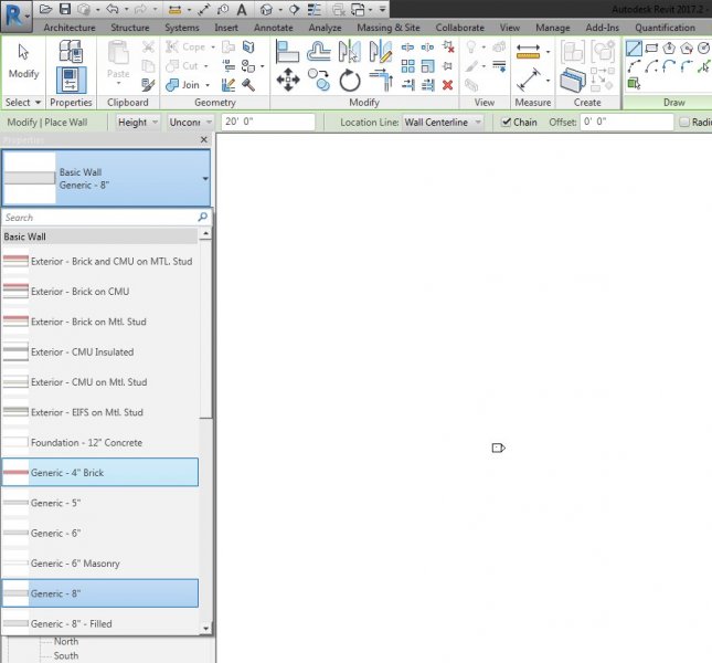

OK, 1st off I do not see a 2x4 exterior wall style in my list. Do I have to create one or start off with a generic wall style and then edit it?
Correct! You will be creating a Wall Type.

Then, the easiest way to get moving is to create a temporary wall off to the side. Select it, click "Edit Type" in Properties then Duplicate the Wall Type and rename it accordingly. While still in Type Properties, click the Edit button associated with the Wall Structure parameter and set the values as needed. You now have your Wall Type created. I'm sure Youtube has tons of this stuff online to show you.
